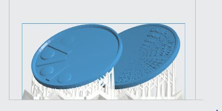

So far after service and changing to clear resin I have had 0 failures on my printer. Good clean mirrors and tank along with good orientation so has helped. I notice many people print their parts at low angles and I try to keep mine so the layers are the smallest and not 90° to the tank. Prints take longer but much faster than needing to fiddle fart with angles again and printing it over.
Typical orientation I use. I don’t like running the parts too flat to the build platform and try to keep the layers as thin as possible while using the fewest supports. Prints take a little bit longer but seem to work really well.
