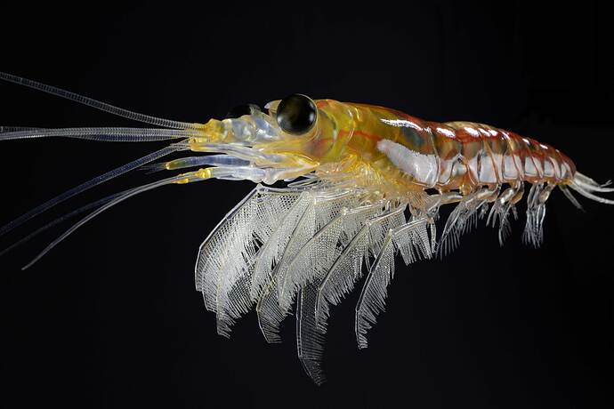

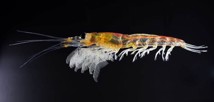

Antarctic krill (Euphausia superba) printed on Form3 and Form3L. over 60 parts. Length 120 cm. Body length 70 cm. The hollowed out model was filled with clear casting resin.
Once again I am happy to work with these printers.
Ciao

How are the veins made? They appear to be on the inside.
Please share some work in progress photos! :grinning:
@ JakeMIsra
In reality, you can’t see the veins, the nerve tracts and the ovaries. Only the gastrointestinal tract can be seen. But the customer wanted it that way.
The innards were also modeled and printed out, painted and then inserted into the model.
