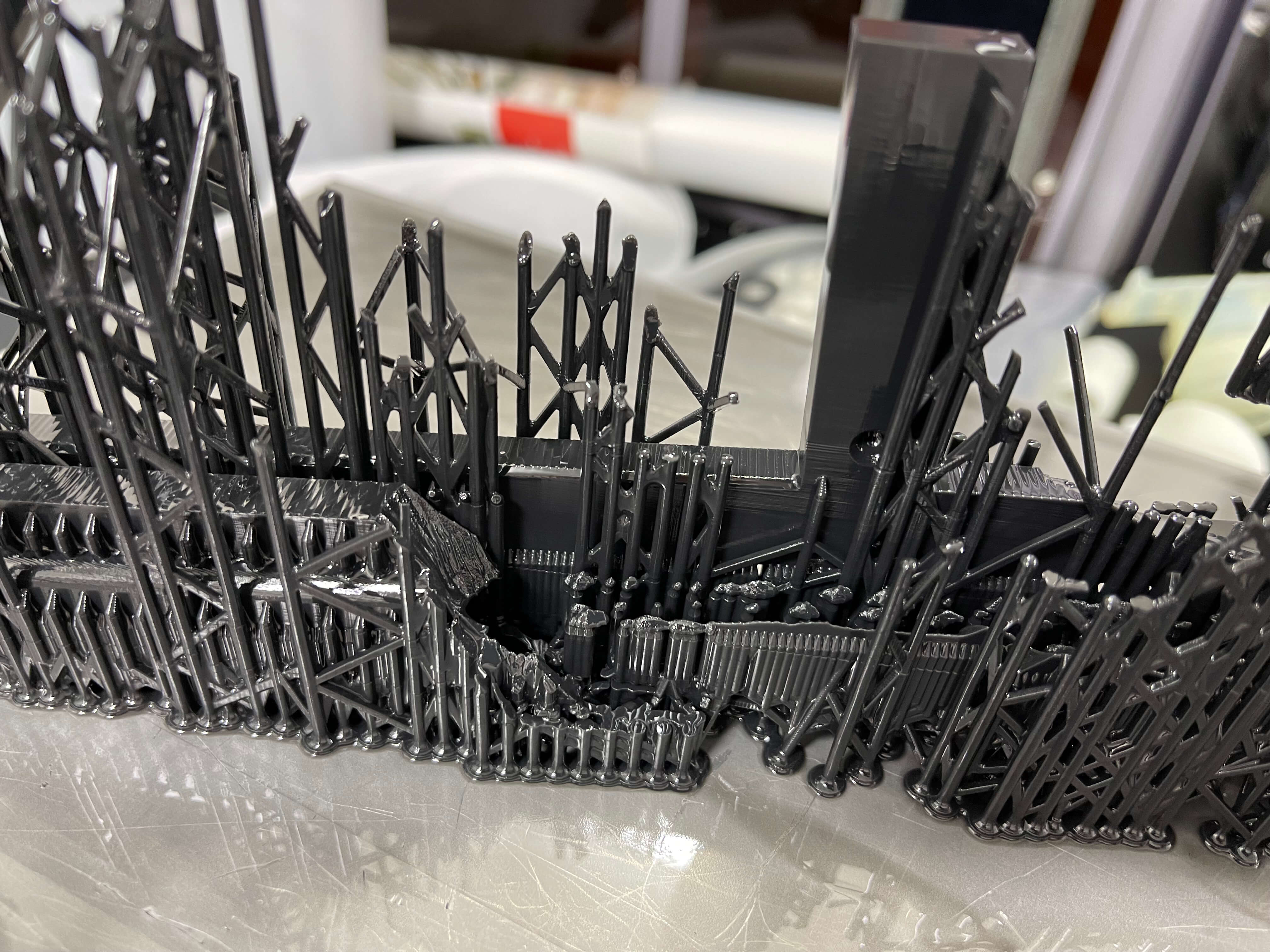

I was feeling brave so I tried a large print.
Luckily I caught it halfway failing like crazy.
Oddly the supports stopped printing around a certain area so it doesn’t have to do with touchpoints or anything like that. Any idea if this is a bug or something went unluckily wrong?
Already contacted support, waiting…
Sorry to see that Eks…in know how you must feel. Just don’t get why this machine was sent out with so many problems. I hope you get an answer other than just shipping you a new tank. For me i think i am going to let mine sit idle for a bit until they come up with some answers. I produced a somewhat good print the other day but it seems you take a risk no matter when you start this thing. Wish i had better luck myself.
One thing i’d like to know. Those layer lines in your print on both ends sitting horizontal. Are those supposed to be in there or is that part of the issue with the print as well? I have some layer lines myself in different areas of my prints. They seem to sand out but i would expect a better finish than that.
Hope you get some answers!
The only answer I got so far was to ask me to send the photos and the preform file which I had already did when I sent the ticket. So yeah, it starts with the wrong foot.
Those are actually layer lines due to the 0.1 forced setting and the piece being tilted. On black it’s annoyingly noticeable, more so after washing and curing.
I’ve been having lots of good prints with small pieces (except for issues with white resin). I had tried black with a small piece so I went ahead with this larger one but I guess large prints for a large format printer are not ideal, paradoxically.
I was told by support that this delamination was most likely caused by the tank’s bottom being warped.
New tank and resin on the way.
