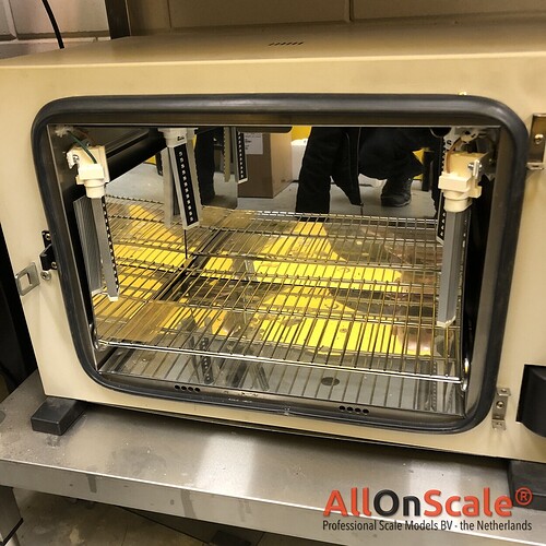

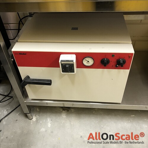

The incubator is excellent as its especially focussed on keeping stable low temperatures. It’s also only 250W. Heats up quick to 60 degrees and the UV lamps do the final 10. The UV lamps are on a timer so I can set the curing time what is needed.
