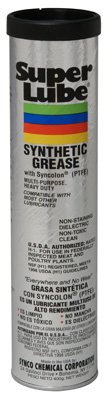

Have put a small amount of Super Lube on the Z axis here and there but other than that I haven’t done anything.
what type of lube and when to do that? At least that is not problem? after 2 liters ? 5? 10 ?
Honestly I’m not even sure if its recommended, I’ve just been around 3D printers enough to see moving parts and want to keep them lubed.
I’m careful not to over-grease and I always wipe away the old before applying the new as well as taking care to not get grease where it shouldn’t be.
I’ve always been a fan of using this synthetic PTFE Lube:
As I’m still not sure if this is even recommended - If Formlabs could weigh in on this that would be great, not trying to mislead anyone…
That aside, I’ve lightly lube twice in roughly 350-400hrs of run time. Usually taking note and cleaning/applying when the lube gets dark.
Personally I would see running time as a better indicator of when to do this vs how many liters have run through the machine.
