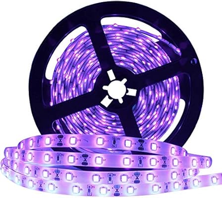

Not sure if anyone is still active here. I obtained a Form !+ and did a few prints out of the box with the Photocentric Flexible at Grey V4 and it worked VERY well. I just canāt get it to cure in post. Does anyone have any ideas on a setup. I did end up putting it in water and setting it under the light over night⦠it is better but still not done. I donāt really ant to have to cure for days and days.
You really need a strong UV light and curing under water to get it tack free. It can help to wipe a layer of oil when done.
When you say strong⦠is there a quantifier to that?
like these?
