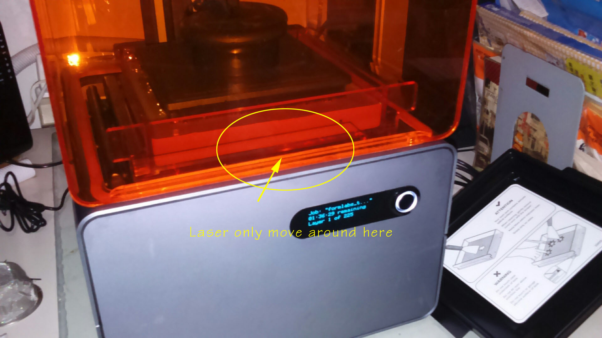

I now found that it has nothing to do with anything except the printer. to my dismay. I tried for the third time using my final new ink tank and a new platform and 100% new resin. Then I noticed that the laser light during printing only limited it’s travel around the faulty area but not the whole platform.
This is the result:
To stop the laser burning through the tank again I stopped the job immediately. I checked, there was no damage yet.
I then tried to print FormLabs’ butterfly test file. Again, the laser only circles the same area.
The first layer of the butterfly file looked like this
Feeling pretty doomed right now…
seems like the galvos are not performing correctly.
did you opena support ticket?
Yes, already opened a ticket and waiting for reply. Haven’t include the latest finding though.
