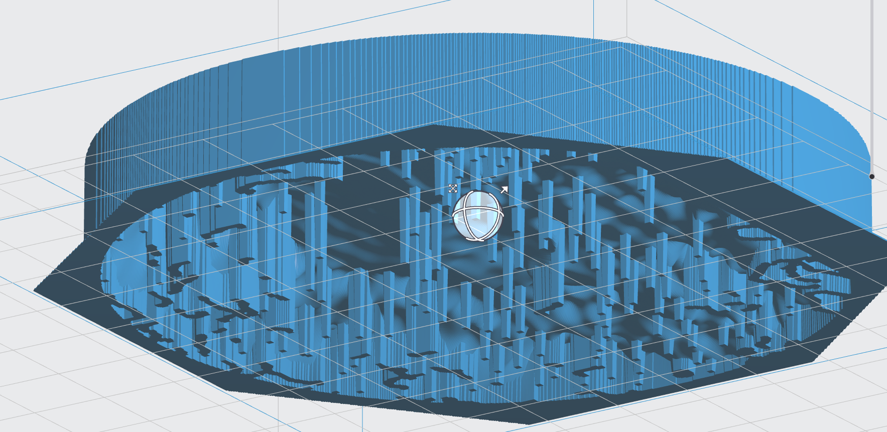

What I want to print:
Unsupported minima:
Yikes. I’d try sliding the slicing slider to layer 1 to see if layer 1 has any material. If you DM me the .form file, I could take a look.
Yeah, if one of those pins is a little longer than the others it might be pushing the rest high enough that they’re missing the first layer. It’d be good to check.

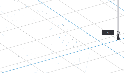

Looking at the layers individually, I must have added some roughness on the bottom of the model somehow. I’ll try and fix the model and see what happens!
Capture
Out of curiosity, what layer thickness is this? To have barely anything by layer 4 I’d imagine it’s 25 µm or else very rough surface texture?
25 µm and quite a lot of roughness. I don’t need this detail but I thought it might make the problem show up more clearly.
Thanks. This is helpful for us to understand the ways in which this new visual feedback can be confusing.
