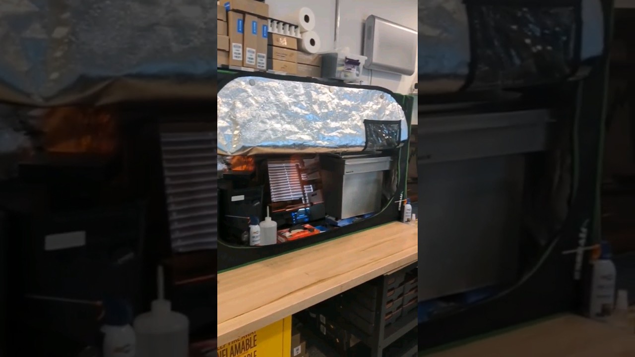

Enclosing the Form 3 in a grow tent
A neat trick that I thought we would share. We bought an off the shelf grow tent + axial fan to enclosure our Form 3 and wash stations so that we could make a DIY fume hood and avoid having to smell resin and IPA while working nearby. It’s been working great so far…video attached below.

quite curious, is it allowed to put the wash next to the printer in the same fume containment tent?
