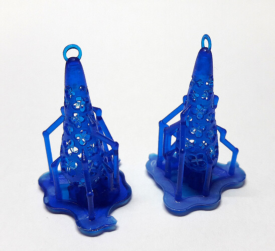

But that part will need a support on almost all of those cutout shapes, there’s many points there that will not be supported. I would go back to the 3D file and add a very thin support on the inside of those shapes to support those points.
In my opinion would be easier to do in Preform because if you change the orientation of the model probably the supports done in my native app could not be useful and need to be changed. Doing in my app wasn’t fast.
Another problem that I saw is that I tried first to put the supports in Preform. Like the model is decimated, in the zone that I wanted to put the supports there are few vertex.
So preform said that It can’t put the supports sometimes.
Maybe if instead of using the exact vertex, Preform use any point on the surface of each triangle, remove the problem.
That message about not being able to place the support generally means that it had problem finding a good path from that point to the ground. It can be common in tight quarters like this. It’s really not very sensitive to the number of vertices.
I had the same issue with a mandala pendant. These aren’t great photos, but the model printed beautifully. I added these tiny threads to any part hanging down because PreForm had missed those, and it printed perfectly. I think they were about 0.2mm, and were easily removed with an X-acto knife. I’m using ZBrush and started creating my own supports because of these details. PreForm would not attach to anything that small, even after trying several different orientations.
