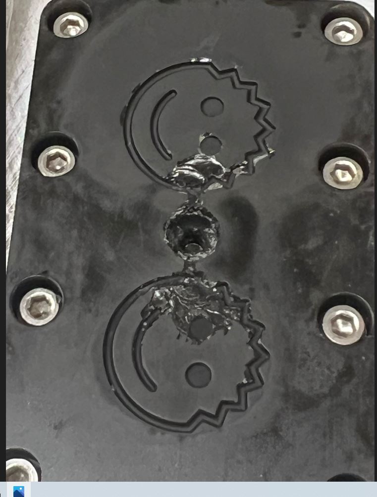

I am after my first attempts at making injection molds printed on a 3D printer. I am delighted with the ease of making these molds, and the quality. Unfortunately, the durability of the molds leaves a lot to be desired. Could the more experienced among you give me some advice for a quick start?
