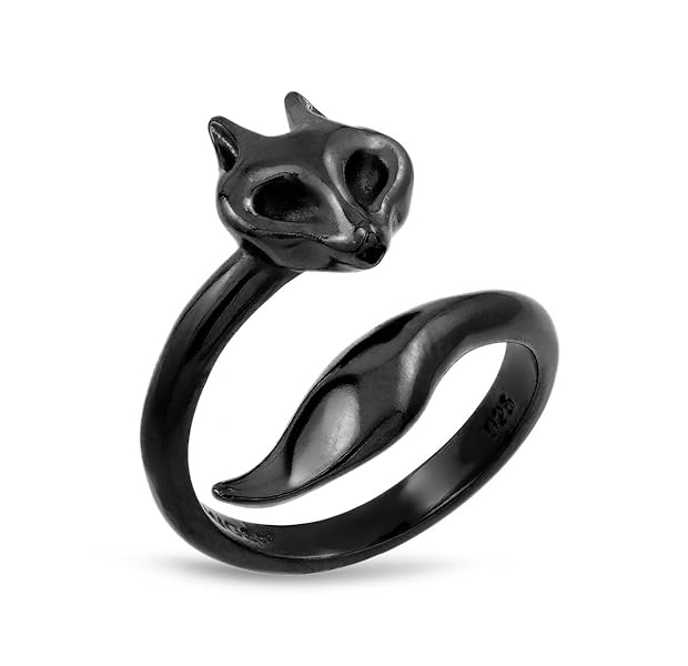

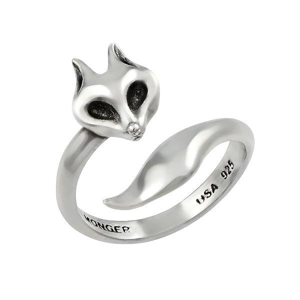

The gold plated and rhodium plated fox rings
and the original antiqued silver fox rings
