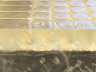

Thank you so much for your fast reply, I already put the plate in IPA over 20mins but apparently I should have used a brush for the whole, although even the 2mm deep lines some of them did not print well at the end just like in the picture shown, does this cross the printer’s capability or just finishing is needed here?

Can you upload a screenshot of the orientation that was used for this? Orientation can play a big role in how well features like these resolve and the other recommendations in this thread like using a brush or syringe to open up the holes can be helpful afterwards.
Thank you for your reply, the object was printed in this position:
Any downward facing surfaces will have extra material cured on them, because it’s not possible to stop the laser from going through the current layer.
