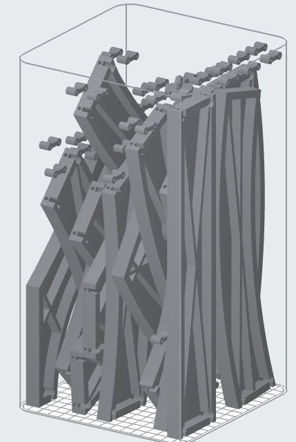

2.5x3 foot logo on the Fuse 1 in a single print
Big print? Stick a pin in it and pack your build volume!

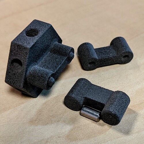

This link-and-pin setup worked well to print a 14-part kit that assembles into a 2.5’ x 3’ logo wall-hanger. 1/8" pins provide part registration, and the links are more than sufficient to carry the load.
The trick to making this low-effort in Fusion 360 is to model the link (the pin isn’t pictured here) and then build a cutter tool as a sub-component of the link. Defining a joint origin relative to the center point of the pin allows me to copy-and-paste the link component, then use a joint to attach the whole thing to the corner of some face without any additional fiddling. The cutter component is extra tall because it makes it easier to click on when setting up the combine-cut operations.

Still needs some final surface cleanup and a nice lacquer. Total fused weight is 1.34kg.
