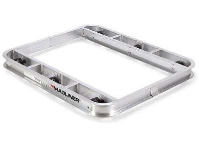

Has anyone either replaced any feet on a Wash L with rolling, lockable casters- or has anyone placed them on a low profile dolly of some sort to allow for small movements. And to be clear, I’m not talking about moving it across a room, only pulling it forward/back from beneath a workbench.
It should be completely fine I see no issues. I would get a cart like this so you can still easily clean the wash because it has a door on the front that swings open but get one with lockable casters.
Would be cool if there was something like this I could use.
