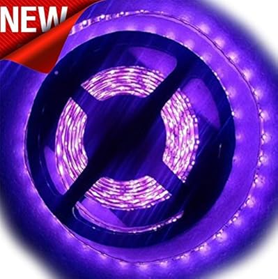

I am looking for a similar strip, but all I see is 5M strips rates 2amps at 12 volts (thats only 24 watts). Can you provide a link?
How many LEDs are on the strip, 300?
Sure. I bought these ones:
60 leds per m at 5m length, so yeah, 300 of them. Don’t forget you’ll need a psu. I bought a generic one from Maplin.
If you are in the states here is where I bought mine… Same company I think.
Note that strip is only 24watts (2amps @ 12v).
Here is the 60-72 watt (5-6 amps) version from Amazon in the States…
Thanks, Didn’t even realize that.
Make sure that you get the 5050 style LEDs. The others are MUCH weaker than the 5050 style.
