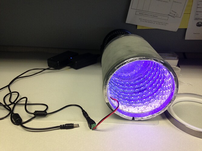

Here is a pic of my curing “chamber”
its simple but no heat is involved and I bought two types of power supplies (50w and 30w) so that I can control the power wattage though the LED Strips. 30w is what Formlabs recommended with tough resin which I assume the slower curing helps with the material properties. The faster you cure it the harder and more brittle it becomes.
