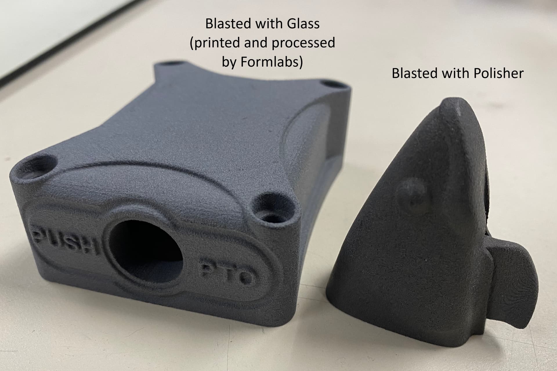

Unfortunately, I don’t typically print threads unless they’re very large so I can’t say for sure how that would clean out. However, I can give some context that may give you a better idea of whether the polisher suits your application. I’ll share an example part and my experiences in how it works with the Blast. I run the Blast before and after dying, for 15 minutes on Polishing, and 3 minutes on Rinsing at 60 and 20 psi respectively.
Corner Radius: I always fillet my internal corners as much as possible but often times this is well under 2mm. This 0.025" (0.6mm) radius clears out just fine.
Small Diameter Holes: For short length small holes, I have had success by using through holes. Some residual powder may be left over but not enough to prevent installing a thread-forming screw.
Tight Gaps: This is where I see the polishing media get stuck most often. If you have detailed features like text or ribs extra consideration does have to be taken. In my model shown below, sometimes media gets stuck in between the embossed letters. However, it doesn’t happen on every part, and any stuck beads can easily be picked out with fine tweezers.
Long Through Holes: Sometimes larger holes don’t get entirely cleaned out if they are particularly long. To prevent this, I use a very undersized drill and a low-speed low-torque driver to make a “pilot hole” through the powder. I’ve been following this practice even when using glass media.
Appearance Comparison: Below is a rough comparison of the finishes. Definitely not an apples-to-apples comparison, but you get the idea. Glass blasting leaves parts looking dry and rough, which may be desirable in some cases. In my application, the polished finish looks much better and almost resembles an injection molded part.
