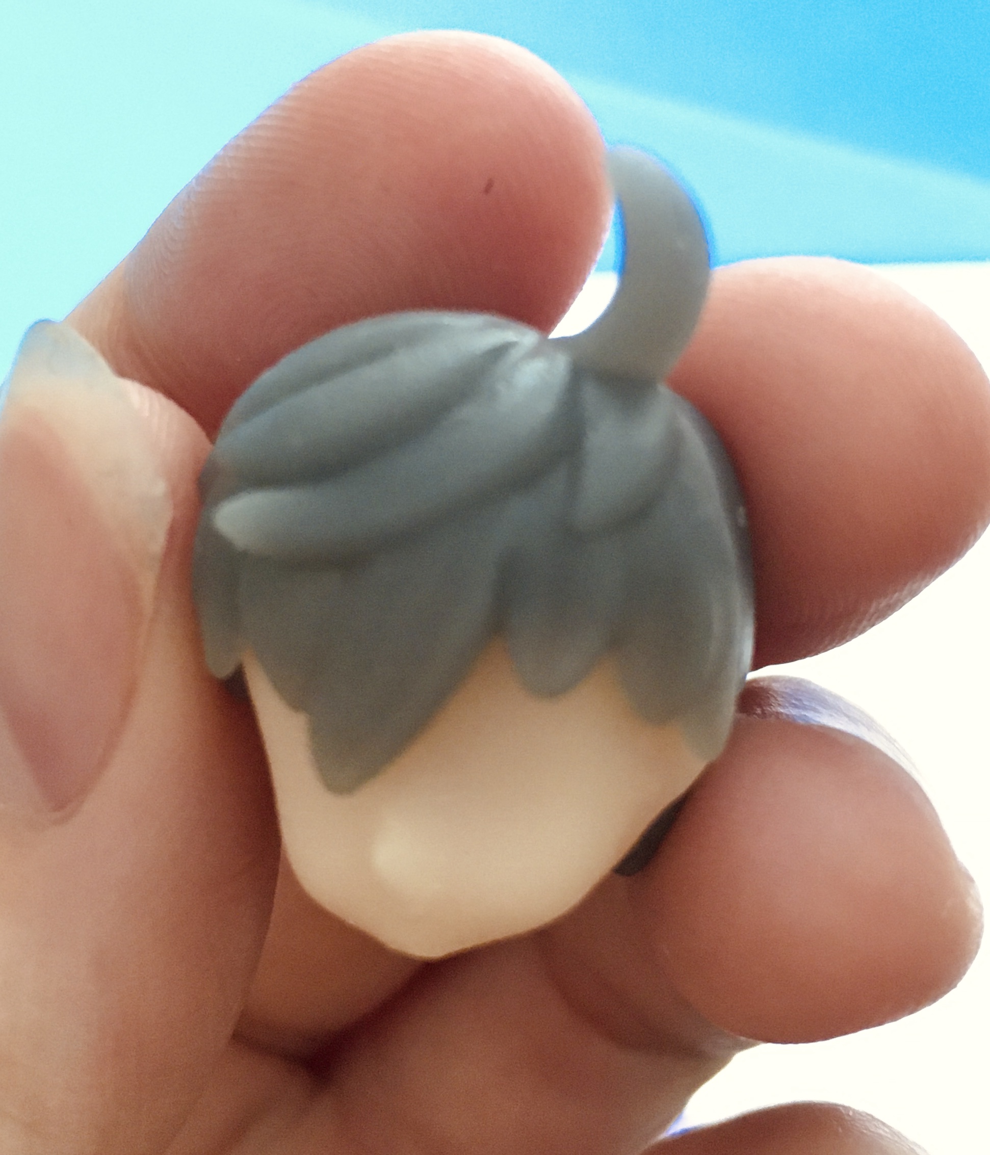

How many different colored bits there did you pigment vs. paint?
All of it is pigmented, the only difference is anything that doesn’t have any fleshtone portions is printed in grey Durable so I can see what I’m doing as I work.

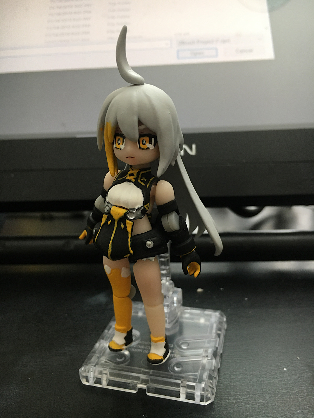

I’m confused - the yellow stripes on the vest or dress or whatever in that last photo look like they’re painted. I’m basically wondering if you made a bunch of different colored resins (blue, black, white, yellow, skin-tone) and assembled it all from very small bits, or if you printed a few skin-toned and grey pigmented parts then painted them. Might be more straightforward if I simply ask, what (if anything) was painted? Basically anything that’s not skin-toned?
As the before paint photo shows, all of the resin is pigmented. The only base color visible along with the paint in the end, though, is Flesh. Anything that has no Flesh visible are printed in Grey to make sanding and painting easier by making details more visible. I don’t print in ‘raw’ Durable anymore because the transparency makes it harder to see details and support nubs
Here’s a good example. Grey parts will be completely painted, Flesh parts have areas that remain unpainted like shoulders, neck, and legs.
Grey pigment is for refining and painting visibility, Flesh is to achieve consistent translucency with subsurface scattering that paint doesn’t allow.

Just needs a few minor details and she’ll be done.
