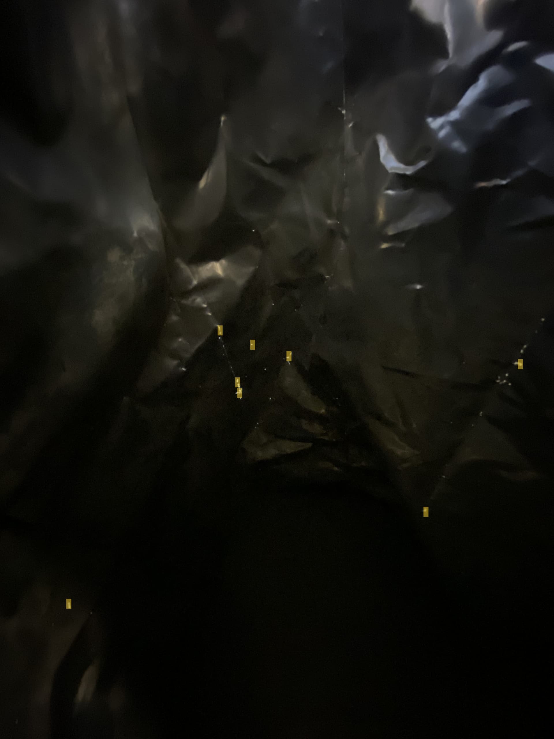

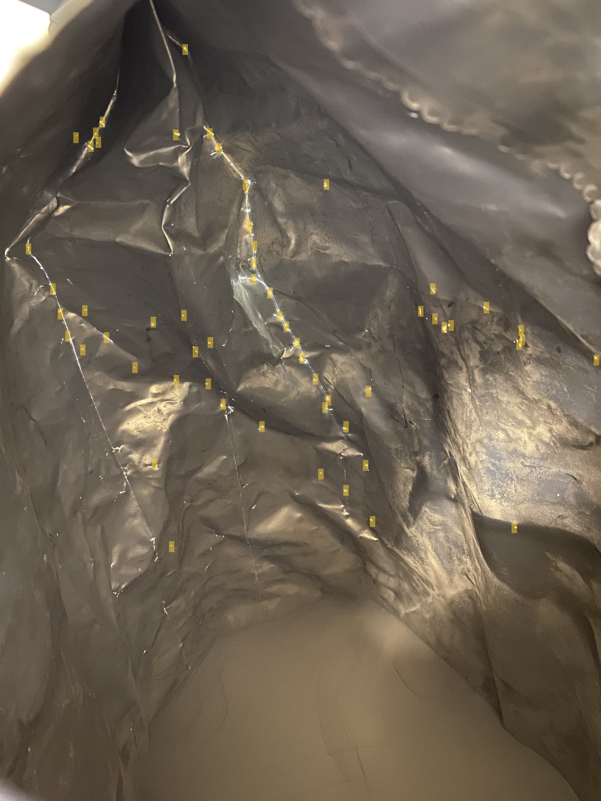

Excellent, I’ll pass this along. Could you clarify the location and quantity of the holes you found in the bag? Were they concentrated in the spout area, or along a particular edge? This info will help our supplier to track down the source of the problem and get it resolved.
It was a bit difficult to get an exact count of the holes, as there are quite a few and they’re particularly small—especially since I can only see the ones exposed near the top after using some of the powder. That said, I’ll provide a rough estimate.
I’m not sure which holes were actually responsible for the powder escaping, as the entire bag had powder clinging to it when the box was first opened.
Most of the holes appear to be concentrated on the face opposite the spout and along the seams (as shown in the first image). I counted roughly 60 in that area. On the face adjacent to the spout (second image), there are an additional 5 to 10 holes.
Holy Cow… you sure no birdshot is in there with the powder? Haha that thing looks like it got blasted by a shotgun!
i know you guys aren’t too happy with the new bags, but using a shotgun here seems a bit excessive

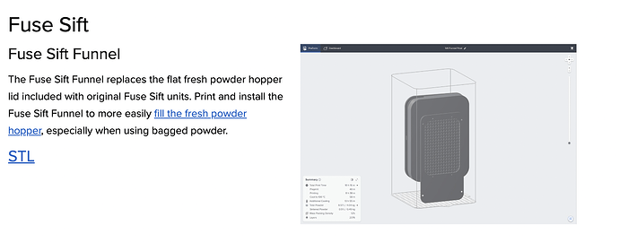

We also have an .STL for a funnel for you to print yourself -
Download the Fuse Sift Funnel STL here!

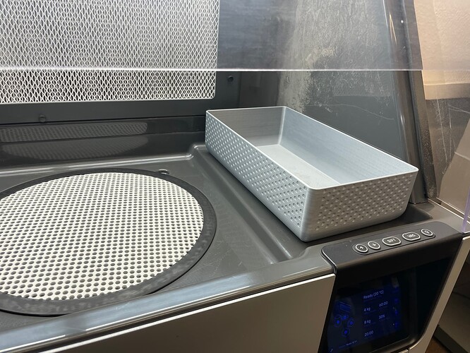

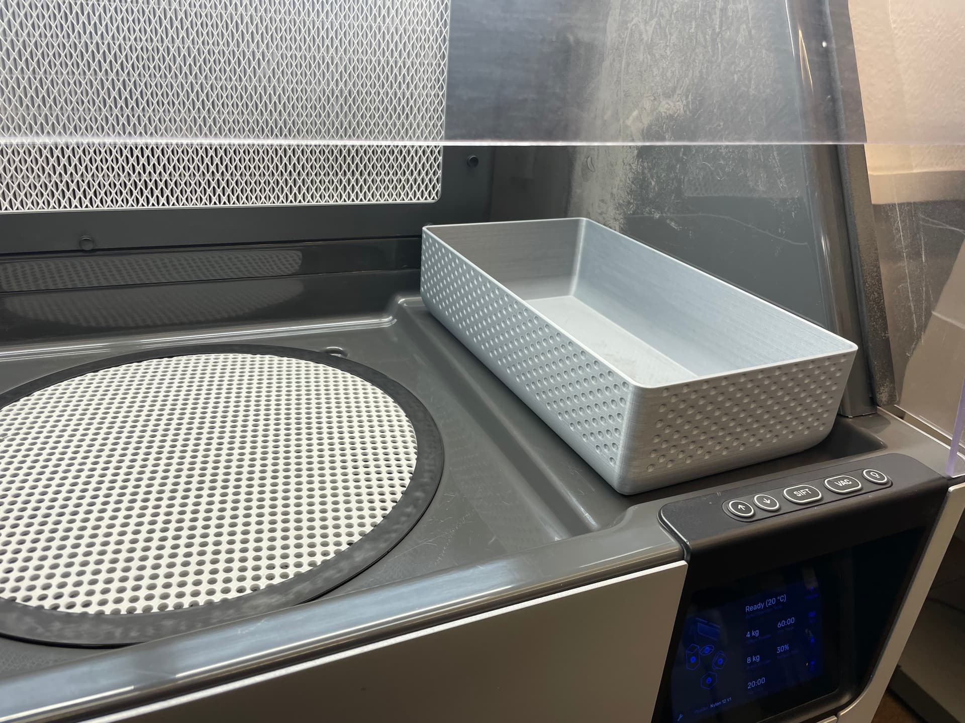

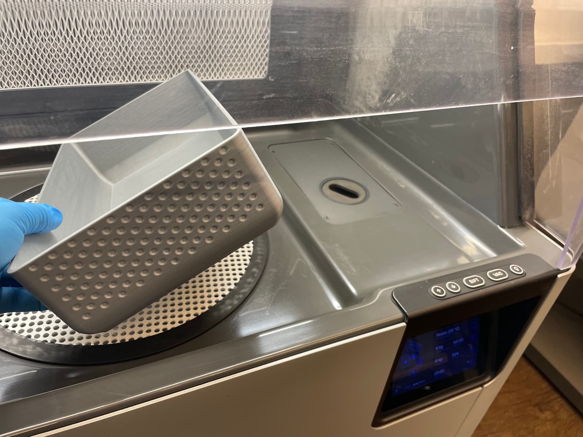

I have now made the switch back to the original cover in the Sift.
Not only does it look better this way, the flat surface also makes it easier to store our component boxes and the surface is easier to clean. My OCD needs that.

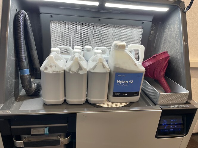

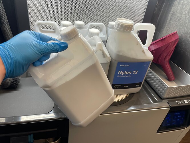

We have now ordered extra new powder containers, which we fill with the powder from the bags using a funnel.
Yes, this creates a slight mess and the workflow is not quite as clean as when the powder comes directly in canisters, but it’s not particularly bad either.
We now always order our PA12 in 20 kg increments, i.e. 2 bags. If we then fill both bags directly into our own canisters in one go, there’s no need to store half-full bags somewhere in between.
We have used 3L canisters here. They are slightly smaller than the original Formlabs canisters, but are very handy and easy to use and fit in the shelf or drawer due to their lower height. Otherwise, 5L canisters might be more suitable.
Because of another recent purchase, I realized again how unwieldy such canisters can be when disposing of them. The advantage of the bags is that we can now order 20 kg of powder and, when compressed, they take up much less space in our waste disposal system than 20 kg in canisters.
