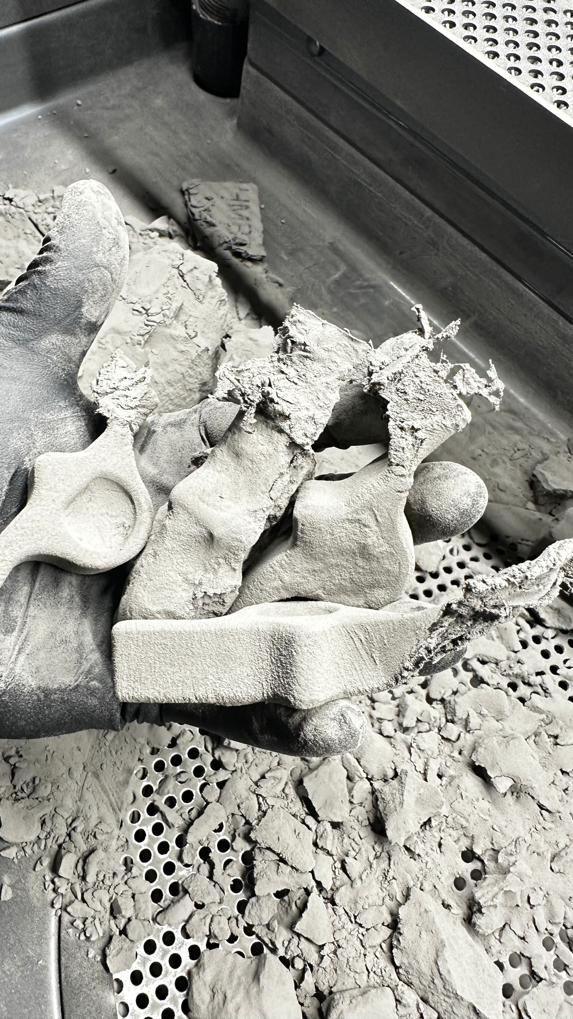

So woke up this morning to another error message on the new firmware release so I am about to roll back to the last version on the Fuse 1 that was running successfully.
The parts from this job were “better” than the last since I zeroed out the Chamber calibration, but still failed do to warping on this new Firmware they released. (You can see pic below, I’ve run hundreds of these units now and all of a sudden the tool won’t fit in the sheath. So I imagine this is due to warping or the parts are no longer holding the same tolerance in scale as prior to this firmware release)
I also noticed that I “baked” the first chamber test with the new firmware. (See the pic below…the chamber plate is supposed to be black/gray and now it is red. So hopefully I didn’t ruin the chamber)
I imagine that half the support team in my emails was correct in that the chamber calibration never worked before…and now that the firmware came out it did work and the +3c setting I had was enough to brick the parts and bake the chamber “red”.
While support is responsive and I believe each of them means well…I feel there is a huge breakdown between them and the folks actually making the machines and building the software.
I am now left really figuring out this all on my own through trial and error while “chasing zero” between their random firmware updates, fixes and this “custom Beta” they built for me to actually run the machine below a 70% refresh rate with Nylon 12 GF.
In the past 72 hours I’ve burned through two half chambers of wasted parts $600+ dollars and hopefully I did not fry a $3500 chamber… and I’m left with a support team that contridicts themselves on the same email thread together…
This used to NOT be red…
Waking up to more errors that I have never seen before the last firmware update
Did another test print as I try to figure all this out on my own…

Well my parts were bricked together as I assume the chamber temp was adjusted on my first test.
For my next few test prints, I lowered the chamber calibration first to zero…then to -.5c. while giving it the benefit of doubt and running the latest PreForm firmware also released… to see if the two would work together.
I was able to run these parts without surface armor curling down to 50% refresh on this new release…surprised…I was able to post process these parts as I believe yes, the chamber temp was adjusted from that firmware and now all the loose powder was free of the part and not “over baked”
However now that my parts are back to being beautiful…they obviously did something to effect the parts dimensional accuracy…as they no longer fit our tool/product. They are too tight.
I even separated the parts more in the chamber to eliminate any possible warping and I went ahead during all this an ran tests on this weeks released PreForm Beta in conjunction with this weeks second update to the Fuse (which looks like they fixed the end of 369 print error)
So I am assuming whatever they did in the Fuse Firmware update…they screwed with the dimensional accuracy of the prints.
Not sure what they did to effect the dimensional accuracy of Nylon 12 GF… but possibly the “Added X/Y Scaling functionality to improve dimensional accuracy” in this weeks 1.16.4? (see below) My guess in their tweaks to adjust for the new Fuse 1+ they threw off the Fuse 1 and Nylon 12 GF

Here is a better shot of the surface armor cracking before taking out the bed

Carlayers
Well at least it is good to hear that there is finally some outside acknowledgement of this issue. I’ve spent months troubleshooting it on my own confident that there was an issue before Formlabs finally identified it and acknowledged it on their end.
In my company I juggle software development and hardware manufacturing, which I know is hard but I’m shocked that Formlabs does not seem to have a machine dedicated and running each of their materials regularly to test firmware updates and material consistency… I swear, it seems I’m the only one, counting Formlabs themselves, trying to run Nylon 12 GF… in the world right now… well maybe not right now…because of the identified bug…
My machine is sitting idle right now, as Nylon 12 is not an option with our temperature and rigidity requirements for our parts. Also, as stated, I don’t believe their Nylon 11 CF is production ready either.
In doing so, I have also noticed an issue in leaving the Nylon 12 GF sit in the hopper for more than a few days, where the lower portion of powder in the dozer and hopper will fail out 3-4 times unless you “purge” out at least 2-3 cups of powder prior to trying to print again. I foresee a “purge” option in the Fuse settings in the future (wink wink to their software team)…but for now a quick “empty hopper” process for a few minutes before canceling the job will do the trick.
As software developers ourselves…I cannot understand why it would take so long to “fix a bug” if it was solely an identified “temperature issue between the Fuse and Fuse 1+”… I find that timeline needed, very hard to believe.
My gut is telling me this is a more complicated issue than they are letting on and talking to some of my additive manufacturing experts/dealers, they fear it may be more of a material limitation and/or problem. In which case, if this can’t be fixed in software, the material itself could need modifying…which would lead to a lengthy recertification of the material itself… I’m sure a software fix would be optimum versus a powder recall and recertification and possibly a change in advertised properties, if for example the density of GF in the material needed to be thinned out.
Regardless, if this was an “identified issue”…I don’t see why a software update to fix it would take that long if the problem and fix was known with certainty.
I will add to this… I’ve never been able to print Nylon 12 GF consistently below a 70% refresh rate on both the Fuse 1 and this Fuse 1+. The only few months that the system worked with Nylon 12 GF down to 50% refresh was when the engineers provided me a “custom PreForm Beta” which magically made the Fuse 1 work…until their very next Fuse firmware update “cooked” my machine.
