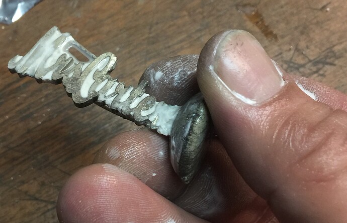

I cast with plasticast and satin cast in 14kt, 18kt white,yellow & platinum I usaully dont take pictures of every step but ill start showing step by step results as i go. Ive only been casting with blue cast about 1.5 weeks. I do alot of orders and every piece ive made so far with blue cast was with a 2hr burnout. Im VERY VERY happy with the results and now cannot do without it.

Glad to finally see results from an actual user instead. Those are not great results on that large ring. Sorry to say.
In fact for me it is better than the formlabs resin. Having these results with a coating of 25 € for 22 kg. for me it is a great achievement. Resin formalbs with Plasticast R & R and melting cycle from 14 hours I have had bad results … I hope to be of help.
