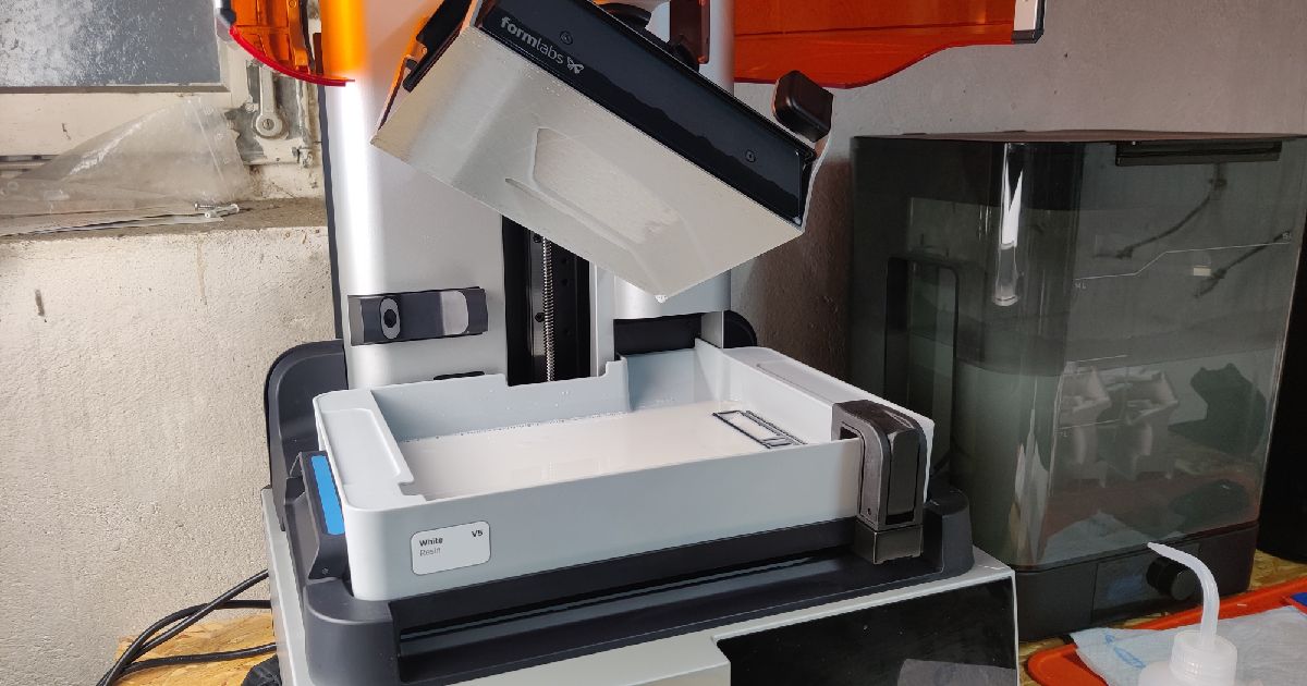

you could let it drip longer they have designs you can print that will hold your platform at a angle to drain off

I printed this model (with my fdm printer), the 30 degrees one.
It works great!
yep that’s what i was talking about
