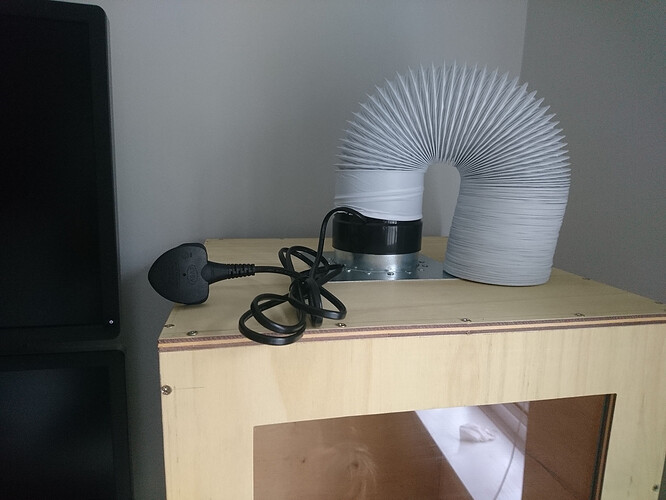

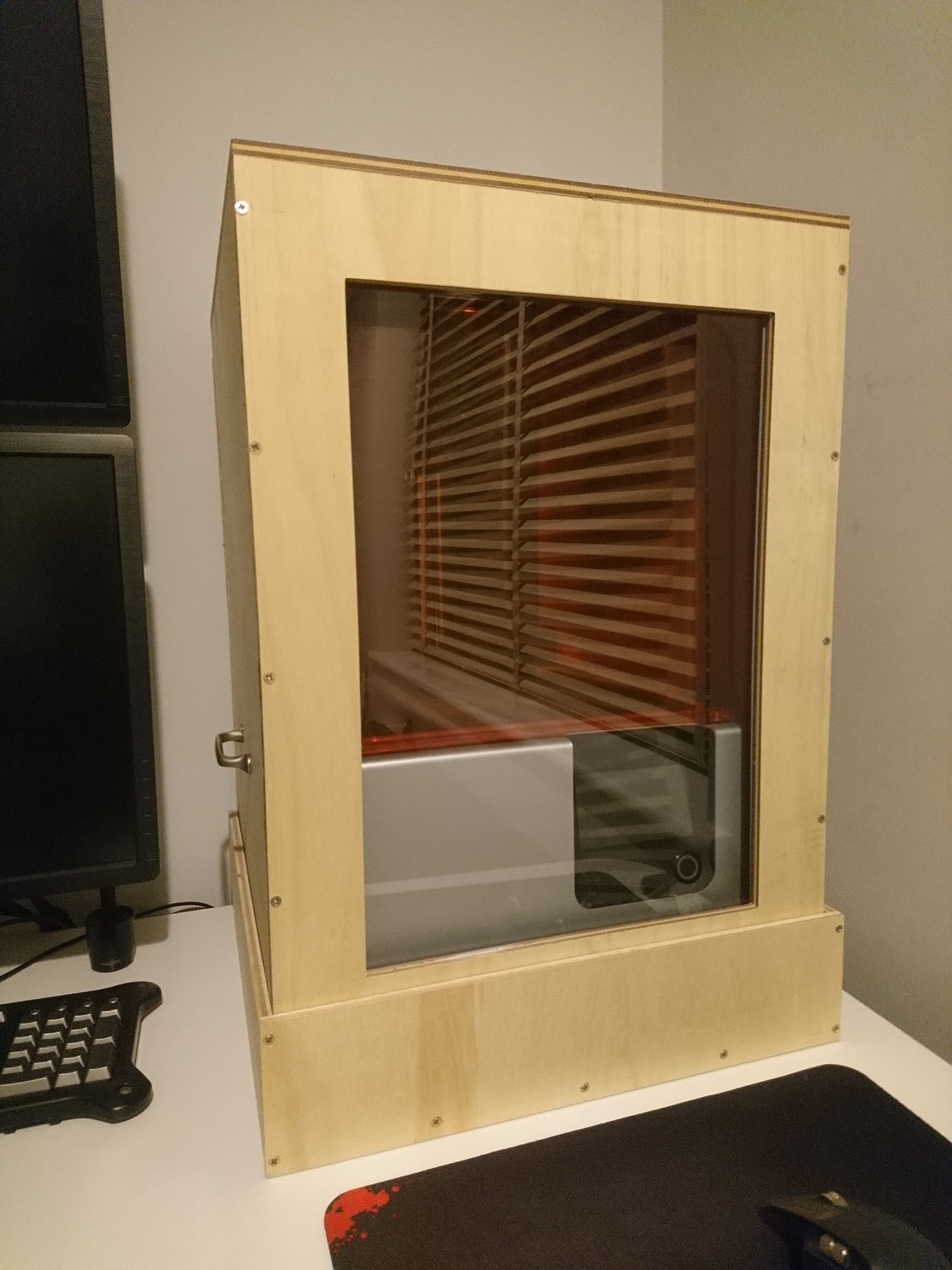

Hey all. Just following up on this, I decided to design and build an enclosure as I will be printing in the bedroom and my partner is allergic to chemical smells. I also have a toddler running about and don’t like the idea of him breathing anything in.
I noticed even with grey resin there is quite a bad smell in the room, so hopefully this can block out the smell and exhaust it out the window.

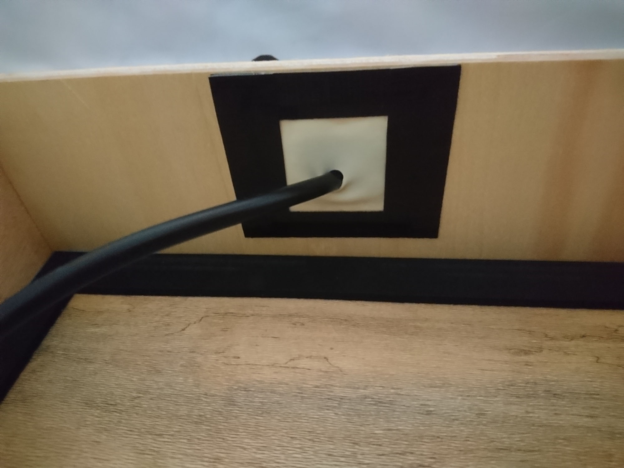

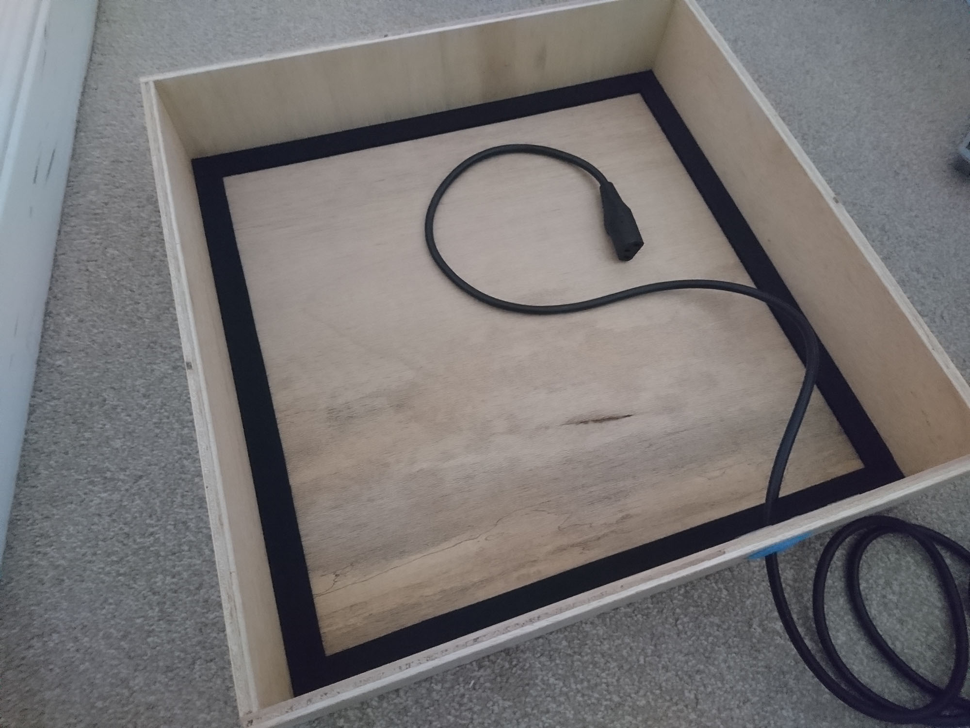

All the wood was ordered already cut to size with all internal cut-outs. I live in a small flat so I don’t have any space or tools to cut the wood myself. I designed it so everything can just screw fit together with wood glue for extra strength. I’ve tried to make it as air tight as possible. The hole for the plug I sealed with rubber sheet that has a tiny hole that stretches over the power cord. The Perspex window was cut to size from the same place.
The idea is the printer sits in the box tray and the top cabinet just fits in snug over the printer. The extractor fan fits perfectly over the output mount, so when done just remove it and lift the cabinet out via handles. There are foam strips in the box to ensure the cabinet is sealed at the base.
I haven’t actually tried it yet so will do so this week. Hopefully it all works!
First time trying this case today. I made a Velcro based card with a hole to put the exhaust hose out the small window. So far I can’t smell anything where as before the room would fill with a heated resin smell. Also the printer is about half as noisy and protected from any uv light as I have the window on the box covered. I’ve been next to it the past 5 hours working.
