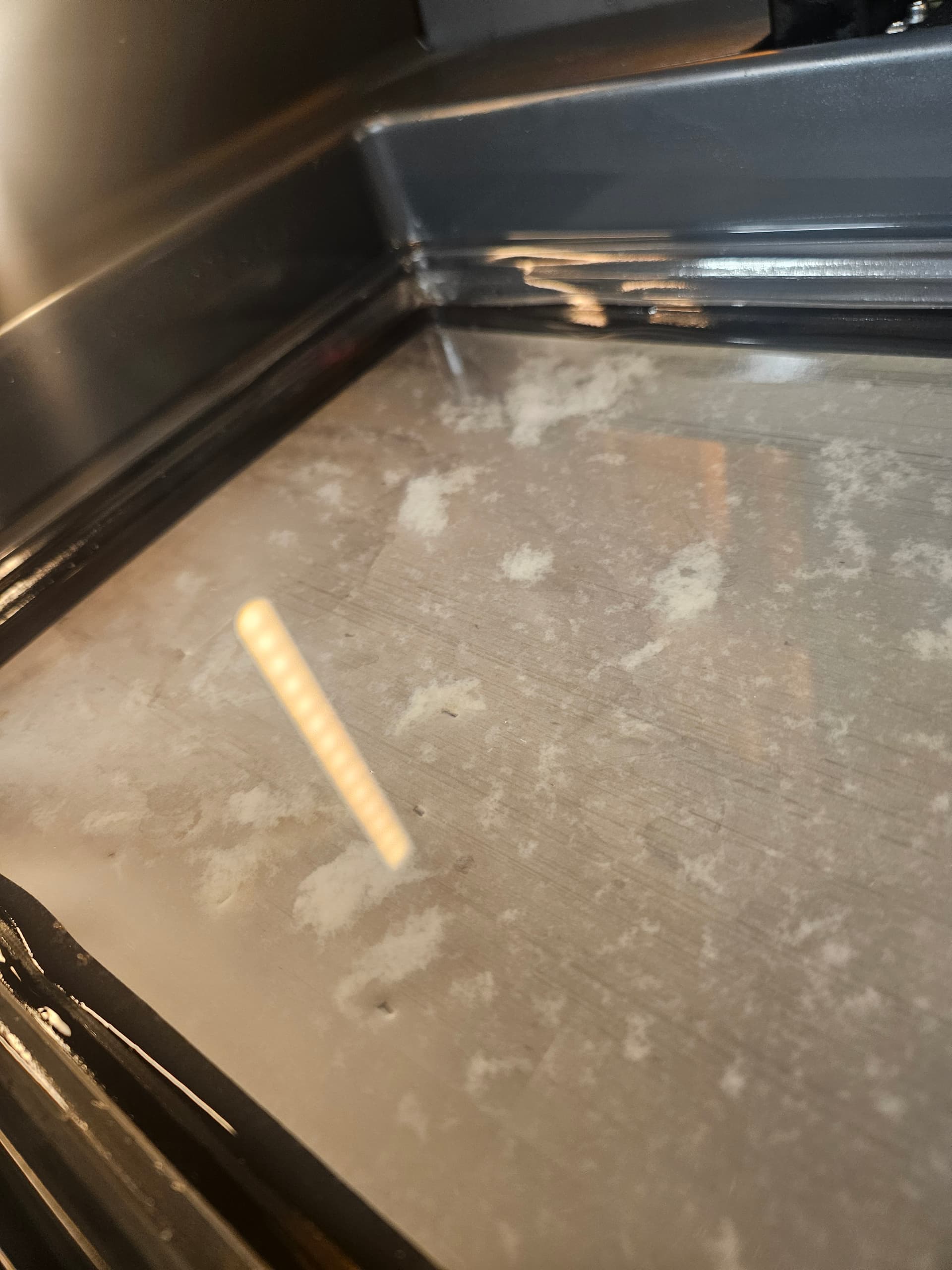

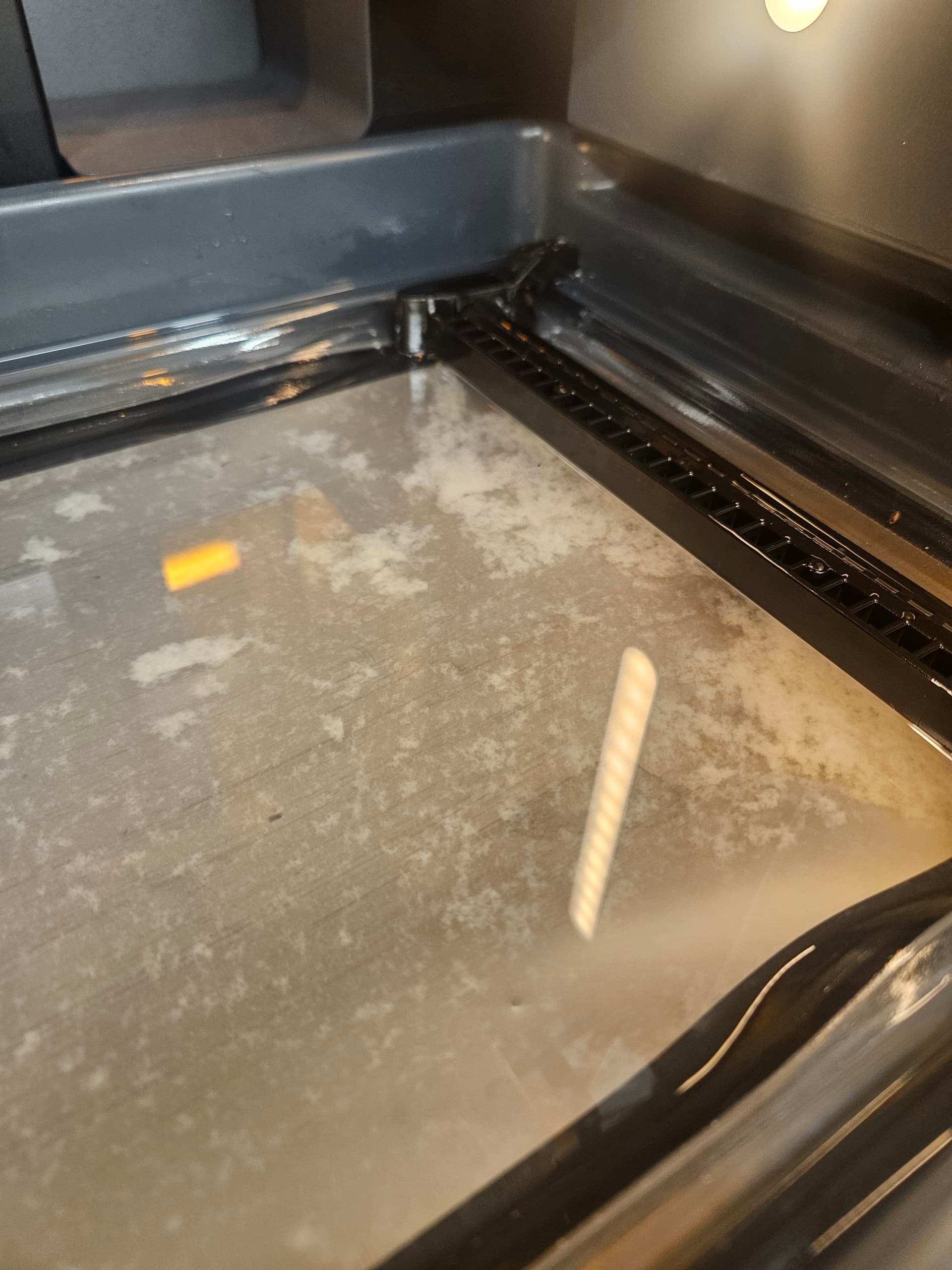

Does know what the cloudy bits in the resin in my resin tank is? Is this just bacteria growth?
Don’t know if you can tell from the photo but the white spots in the image are not from the tank itself but suspended in the clear resin.
Will I need to chuck my entire tank as well as resin or will be able to clean it out with alcohol.
Thanks!
Hi @khsieh ,
Thanks for letting us know about this issue. While it’s hard to say what the cause is (did it happen with other tanks? At what temperature are you storing the tanks?), I’d suggest you clean the tank and filter the resin, and then try printing with them.
