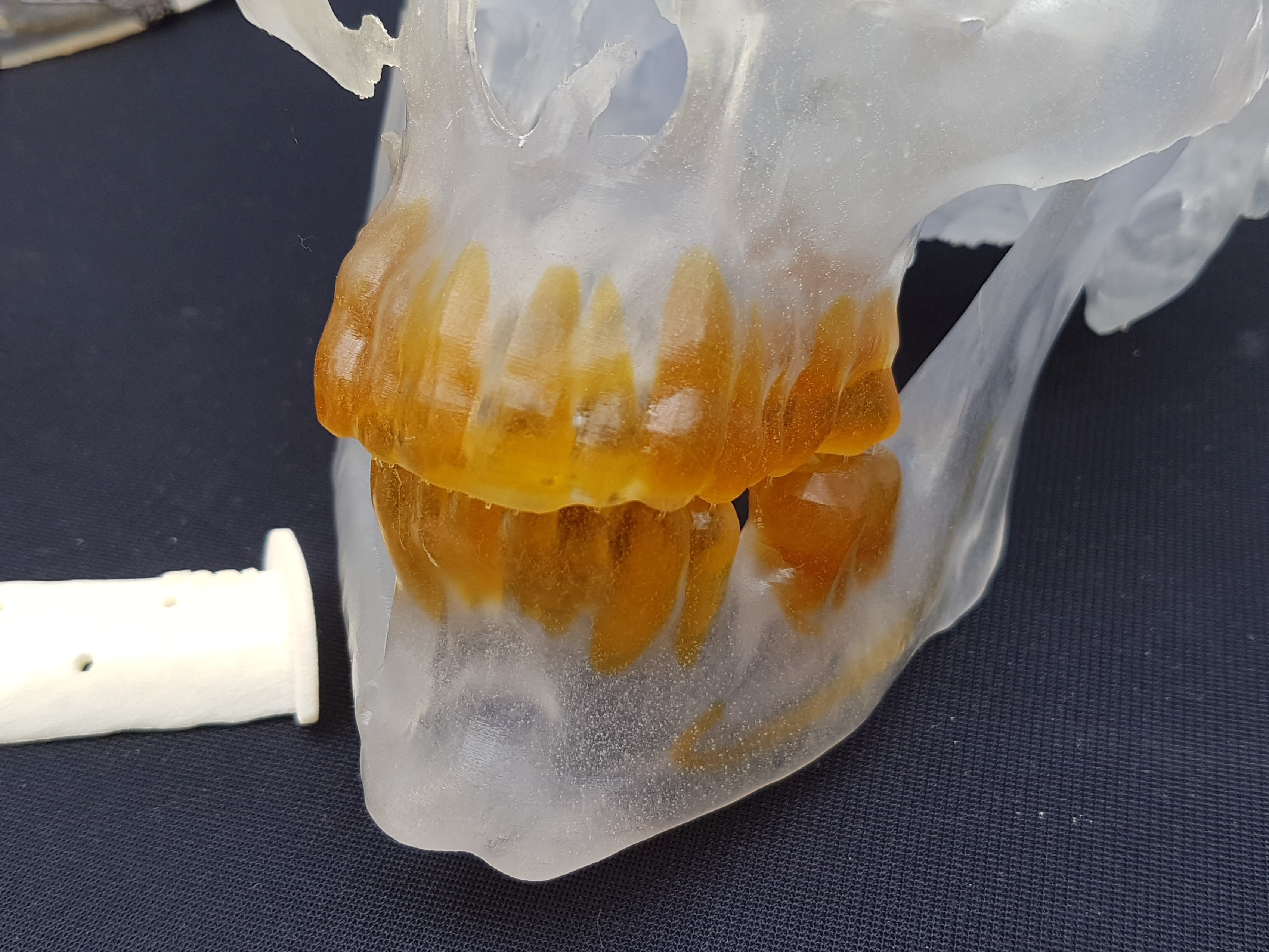

Can you provide a product name or a photo or a link to what you are talking about?
Hi, sure. Here is an example. I specifically asked how it was made. It was an SLA Printer.
Best regards.
I wonder if they’d be able to make other colors than just clear and orange-ish.
My guess is they are using a resin that is very bad at resisting UV light and gets a strong yellow tint when it’s exposed to the laser for longer than the nominal cure time.
There is also the possibility of using irreversible photochromic pigments which basically are clear when not exposed to UV light but then change color as they absorb UV and don’t revert back to a clear color afterwards. Still, they would be only clear and another color, not really two different color AFAIK.
Also, this would mean over curing some parts and not others, wouldn’t that cause geometric irregularities in the print, just like printing a part directly on the base does ?
Models like these also exist with clear and pink instead of clear and orange.
I don’t really know how it’s done. Maybe no post curing is needed after printing. The techs, engineers and material scientists from formlabs probably know it. Alternatively it might be possible to find a patent in the Google patent data base.
If the resin changes color as a function of how cured it is, and you post cure so all the resin is fully cured, the result would have to be a print that is all the same color…
that is true. but maybe a kind of overcuring is possible which would lead to a color different to fully cured areas/parts
Wonder if that was done with a top down dlp printer where they print one color one set of resin then change resins and print the other resin like an over mold?
I am not sure how that would work. could you elaborate on that, please ?
best regards,
Jan
By the looks of that particular print I am guessing it was done on a polyjet that has multiple material heads. If it was done on an sla of sorts the only way to get different materials is to literally change the resin. This is no way of having 2 different resins in the same tank at the same time.
The only way I could think of doing something like that would be with a top down style machine such as some of the DLP printers are done and you would have to print one color. Leave the part on the build platform then change resins and print again. This wouldn’t be possible on a machine that print from the bottom like the Formabs because you wouldn’t be able to build layers with a structure in the way.
Yeah, there’s no way an SLA printer can do that type of thing.
Both the red and the yellowish tan colors are made by hatching (overcuring) certain resins which change color with exposure to UV. The tan tint is made with Somos Watershed and the red is Accura YC9300. The software for certain SLA machines allows to submit overlapping STLs with different cure parameters. The models need to be protected with a UV absorbent clearcoat, but will still gradually discolor (rapidly in direct sunlight). I have asked FormLabs for that for years (since beta testing Form 1). We use it all the time in biomedical models for marking teeth, nerves, tumors, as well as marking patient names. You can see several examples at www.biomodel.com
