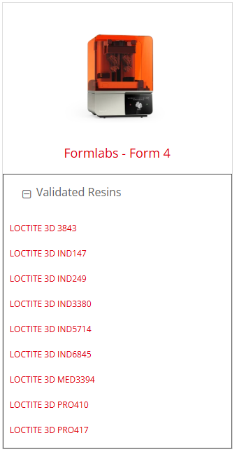

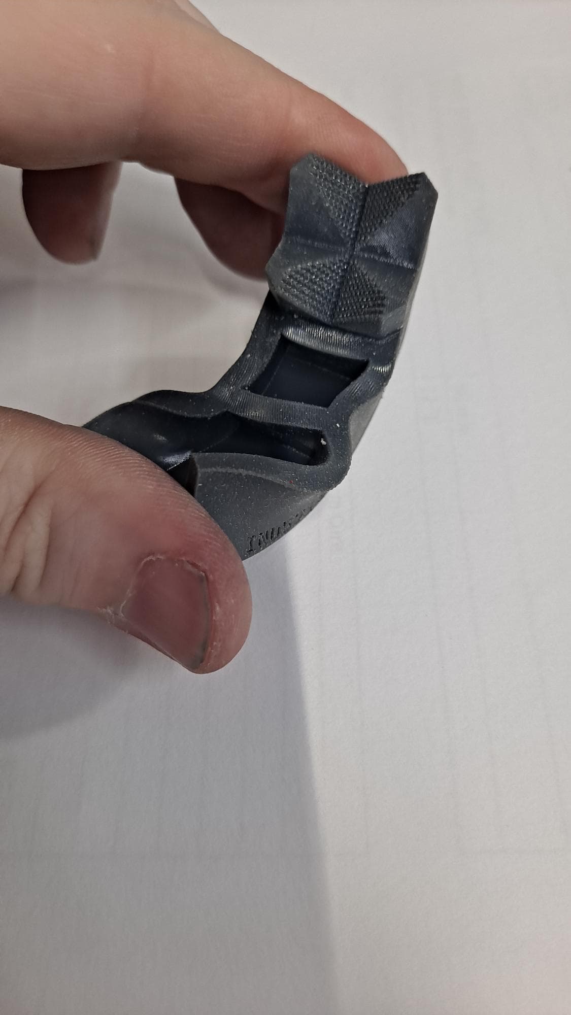

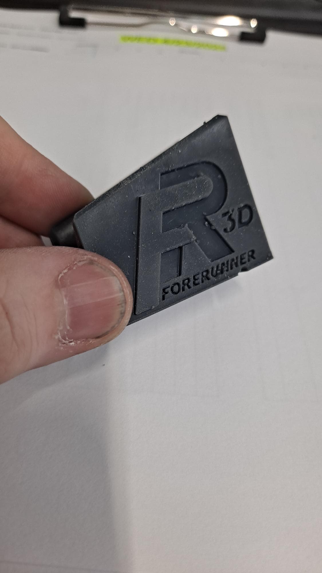

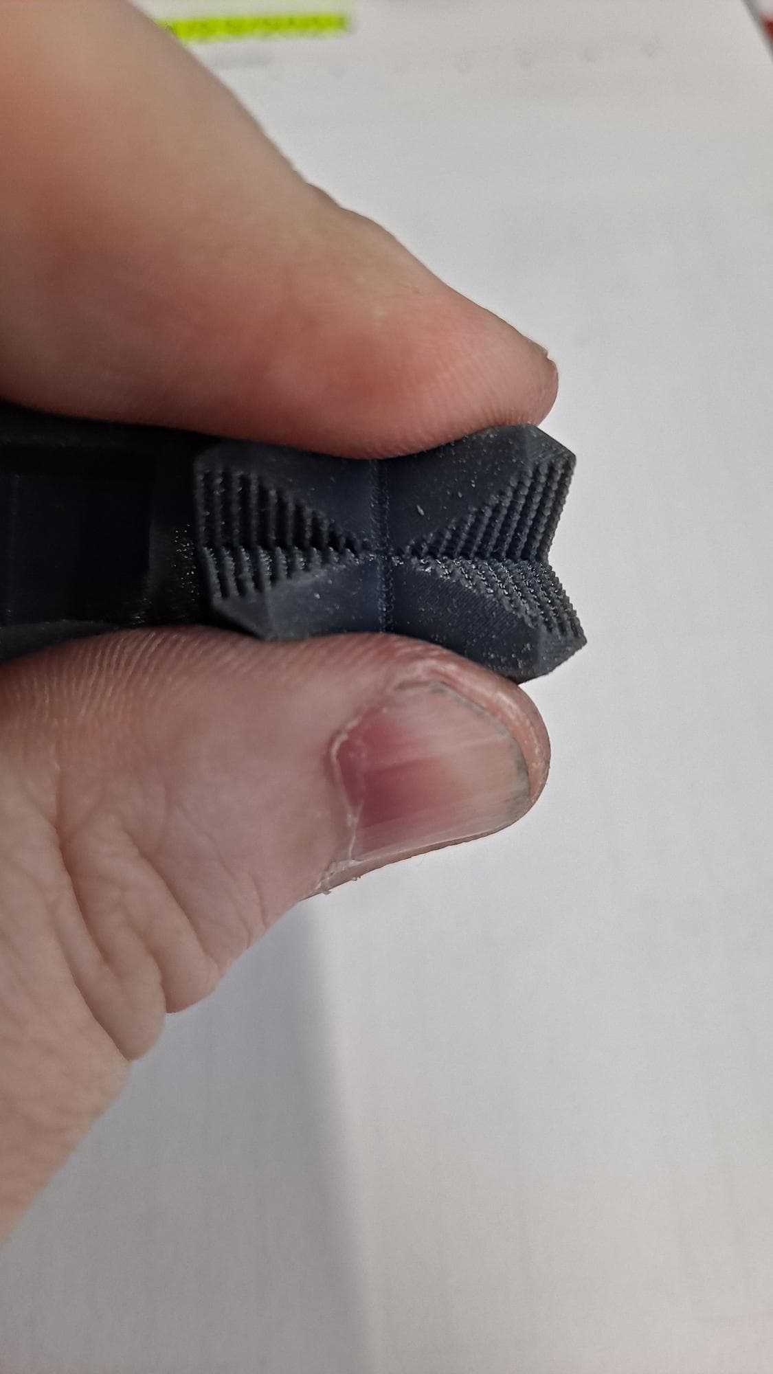

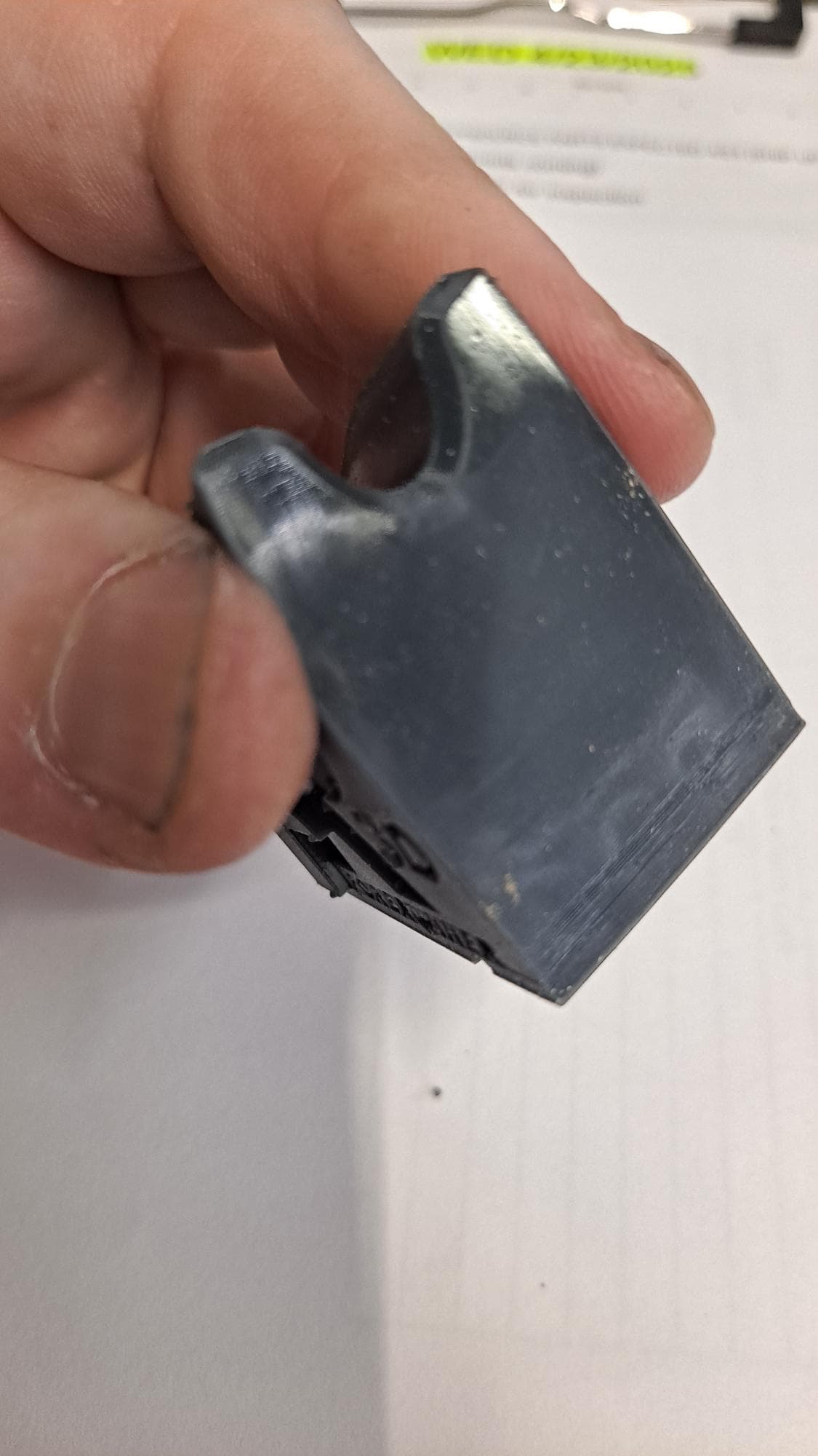

We have been using the OMM for a few months and having great success for the Form 4. We have been working with Loctite 3D Resins and having great success. The easiest way to use another company’s resin is finding ones that already have tested and validated their Resins for the Form 4(or Fuse) Loctite currently has 9 resins that are validated to run on the Form 4.
and we have been working with them to get even more validated.
Now if you are more knowledgeable about the Formlabs Resins and how they work you can also play around and get prints from resins that haven’t been tested on the machine as long as they are a 405 nm photopolymer resin.

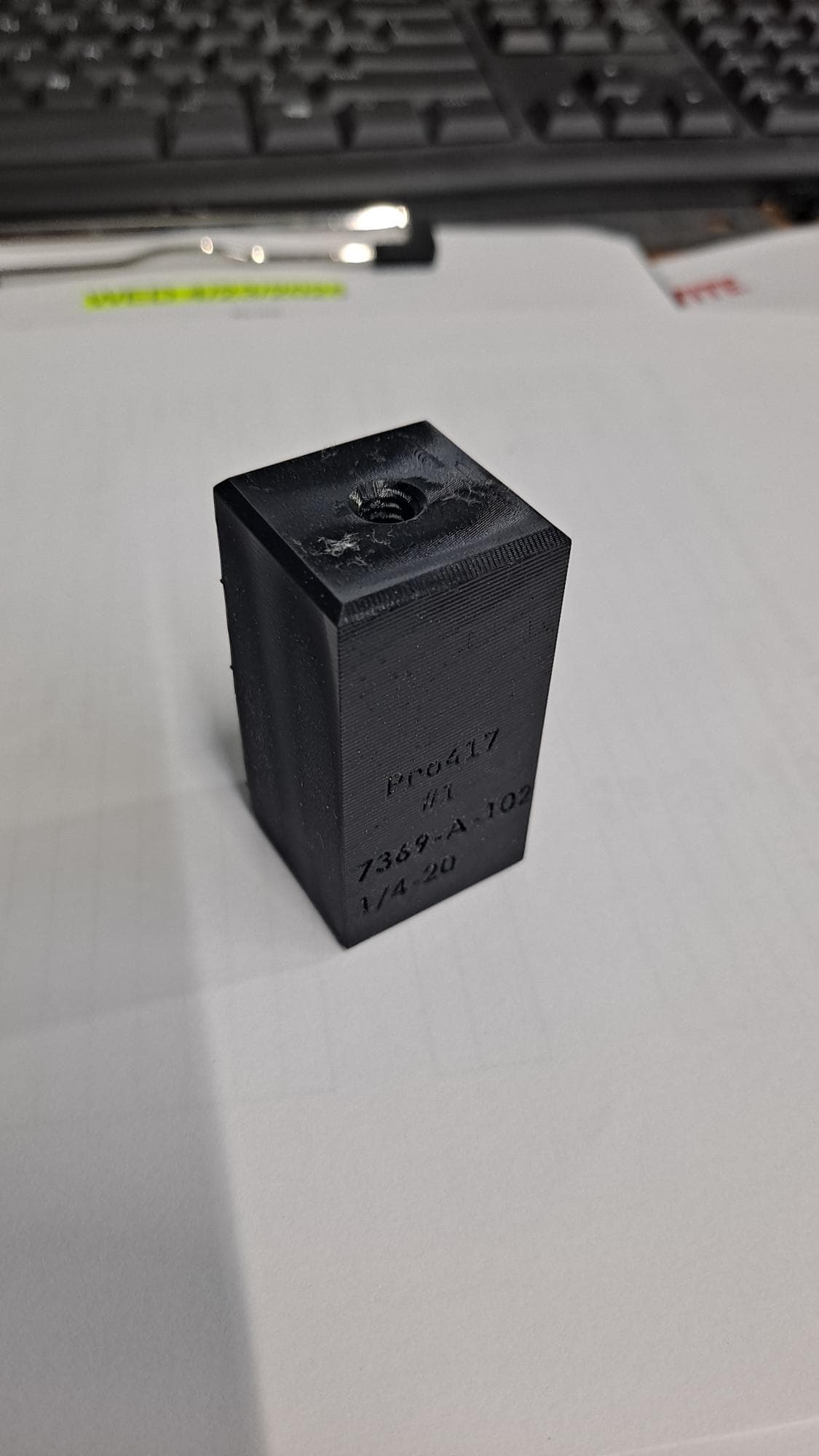

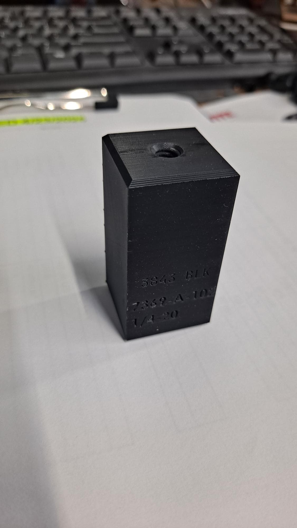

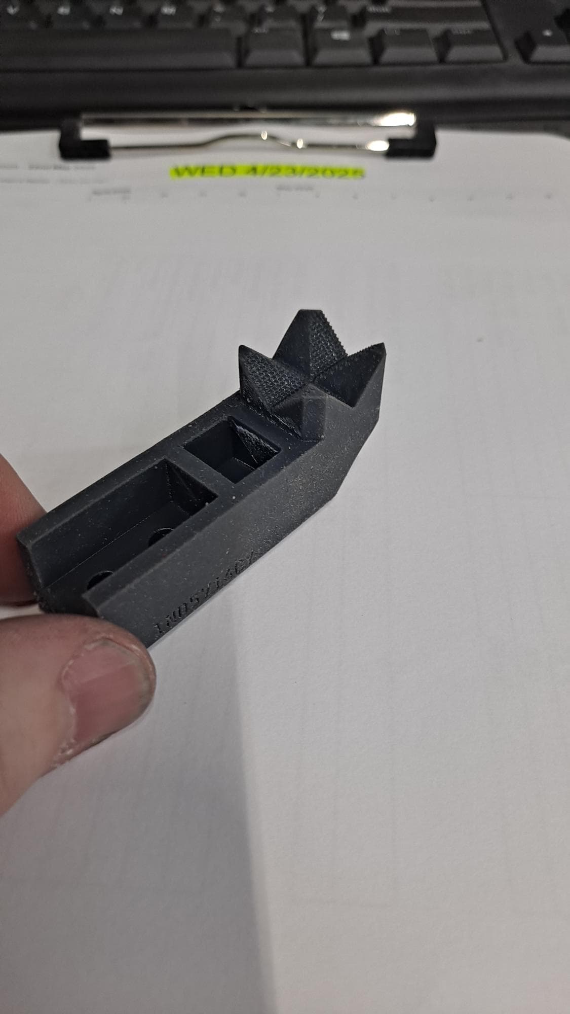

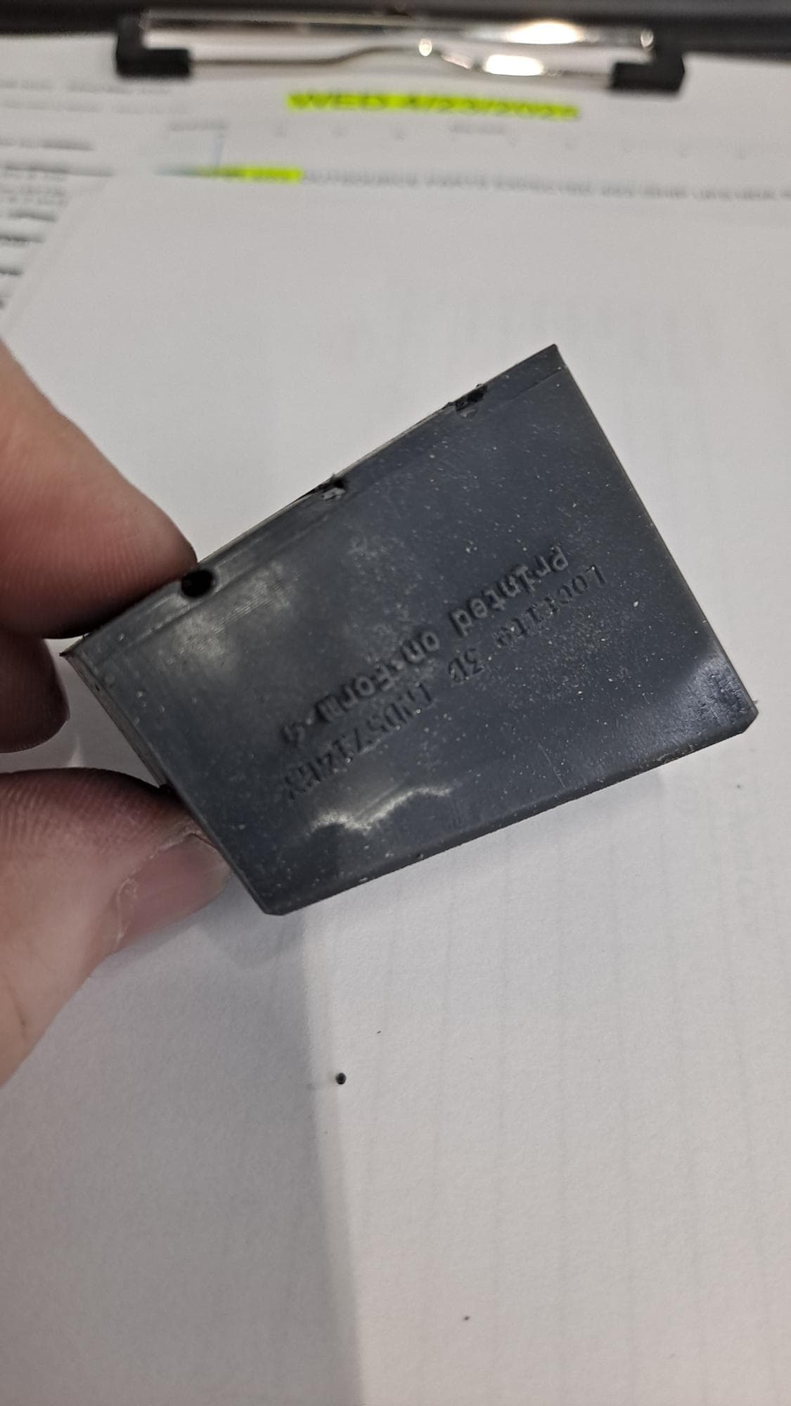

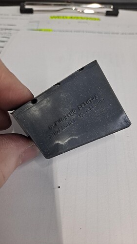

Here are a few of the successful prints that I can share here:
Loctite Pro417
Loctite 3843 Blk
Loctite IND5714 GY
If anyone has any more questions about the successful use of the Open Material Mode from just playing around to printing parts for production jobs, feel free to reach out to me.
