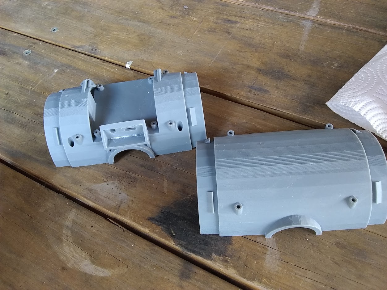

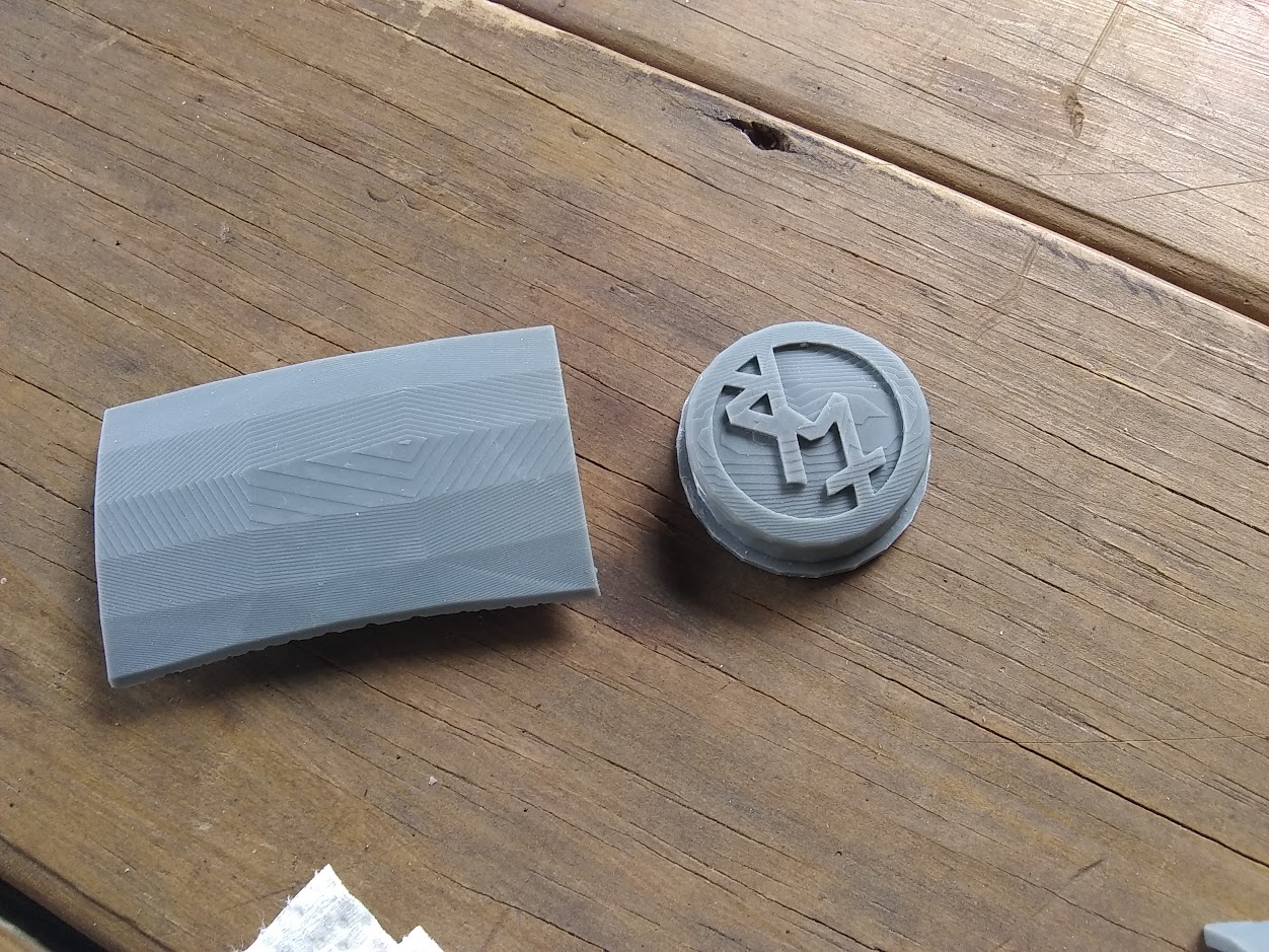

Honestly the smell is appalling and even remains after washing it in an alcohol bath twice and leaving it to sit outside. However, I will say that the print quality so far actually is pretty good. I printed my parts directly on the build platform as suggested and with internal supports on large pieces and they came out pretty good. I also tried one part without any supports and with the shape parts I was printing there was mild deformation on the one. This does not seem to occur as long as I use internal supports.
Other solid models I have printed directly on the build platform and with no supports and they came out great though. ![3|666x500](upload://xLe39vqxm7eRGCQUUG9RgcNpKeL.jpg)

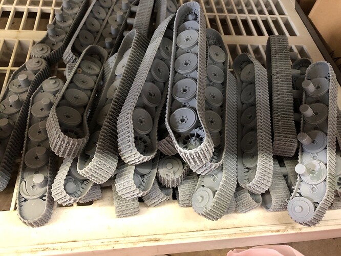

There was no way for us to make any money doing batch manufacturing with the FL material prices. No way. I tried to negotiate with them on drums, pales they weren’t listening trust me. So we formulated our own material and have created so many cool projects. We typically do runs of 50-100 products using Form2 printers. Formlabs really seems to have no interest in scaling the material for small batch manufacturing on a serious scale. But with DFGREY its possible to do just that. It seems some of the other 3D printer manufacturers may see the light soon enough, or, I hate to say it: China companies will. Anyhow some pics of our batch runs using DFGREY ( no smell once they dry and cure :slight_smile:
