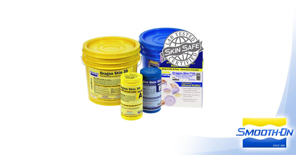

Maybe not quite as hard as you would like but here is a platinum-cure silicone with Shore 30A:
Smooth-On makes great products. Maybe consider having an insert to stiffen it up if necessary.
