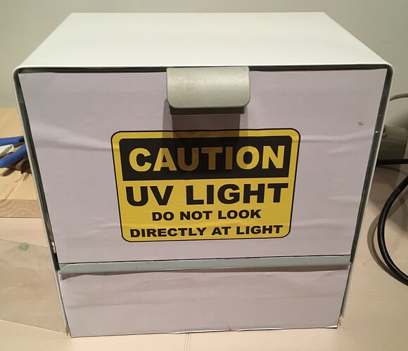

Formlabs resin uses UV light to cure. What do you mean by “Wood Lights”? Do they cast UV light?
I believe @MauroCampana is referring to a black light.
Yes, " Wood Lights " and " Black Light " is the same tipe of lights: https://en.wikipedia.org/wiki/Blacklight
I have a stripe of wood lights and I want to try for cure the resin.
We made a tutorial for building your own UV Curebox here:
It uses a 36W nail light so as long as your wood lights are equal to or greater than that wattage you should be fine.
Thanks Jordan
I made a cure box with a old small oven that I have.
I used the LEDs at 405nm and “Black Light” LEDs that I had ( about 100 watts total ) and it seems it works.
I wish you a happy weekend.

<img src="//cdck-file-uploads-us1.s3.dualstack.us-west-2.amazonaws.com/flex025/uploads/formlabs/original/2X/5/512d2853138d827a30d99ec0b7c2c4c5fb897467.JPG" width=“516” height=“500”
