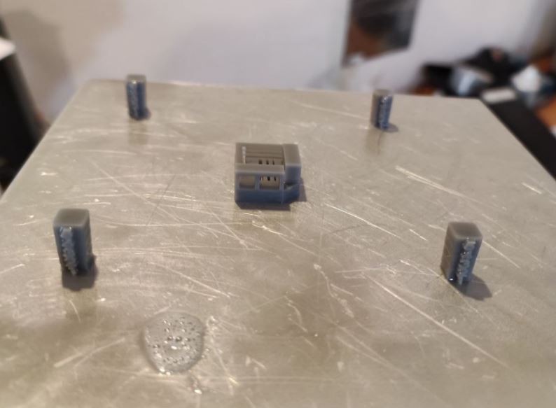

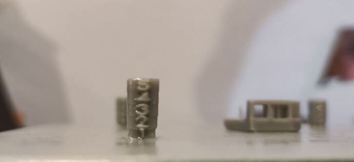

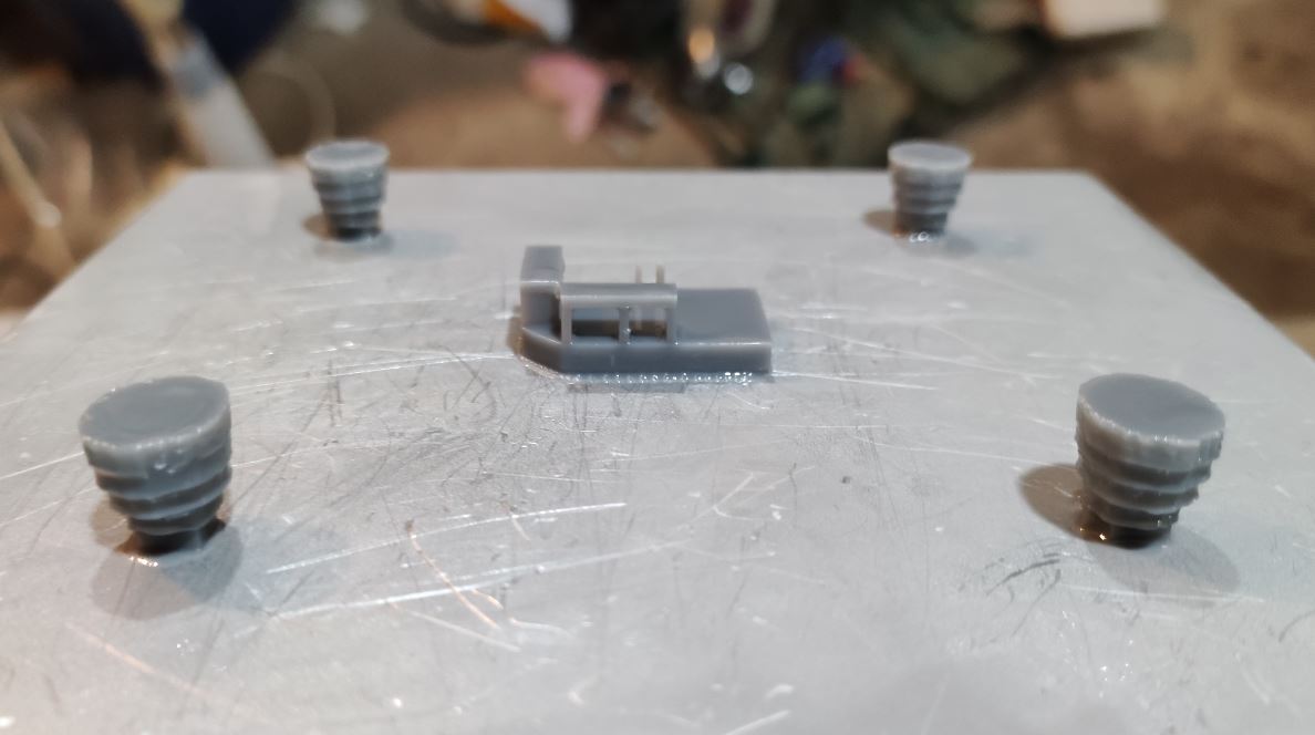

Here is the first result of the optic test
Need some calibrating on center position but this can be solved.

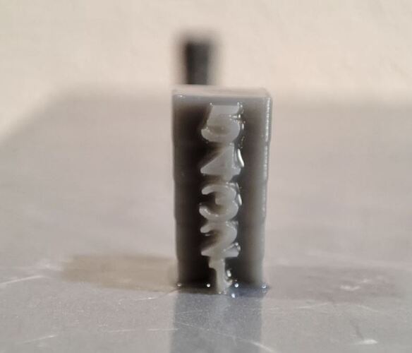

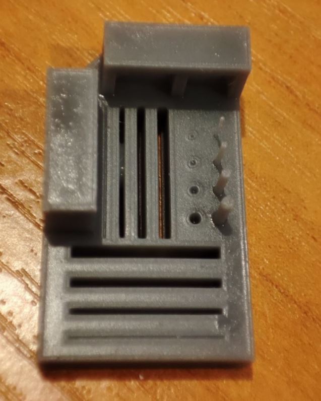

Any of you know what the sizes of those pieces are supposed to be? I did a test print a week or two ago and had no idea what it should be.
The best result is if you will get columns with no steps, just digits. And in the middle plate will be all details
https://drive.google.com/open?id=1GW7x_NueaZ4DgMZarj5_MhzgtdGFzntf
This is manual for the optic test. And there are photos of a good results.
