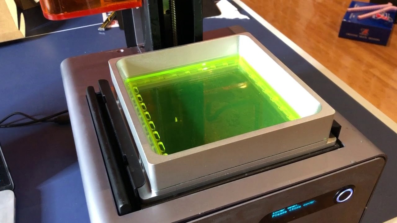

I came across this project of @X3msnake who uses MOAI FEP VAT:
Needing this part:
Here in action:
This is interesting since i think it coud be easier to clean and manipulate than with the PDMS layer.
Have some any of you guys tried this ? With good results ?

Hi @Stereoleap glad you keep the old Form 1+ around, I myself just bought one too just recently. I got 3 vats came with it but unfortunately the PDMS worn out pretty fast especially with print using the whole build plate, so I did opt for the Moai one.
I would say the Moai vat is one of those very over engineered and very well built, just be careful not to scratch the bottom acrylic piece and also watch out when you fill the resin, don’t go over the line or else everything will overflow and splash everywhere. Personally, setting the vat offset to be 0.40mm higher in Preform works for me.
