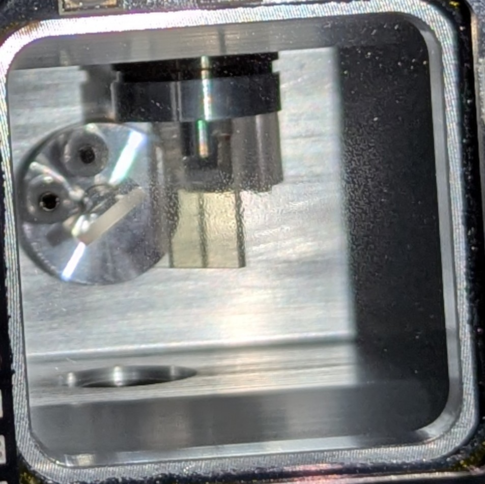

Our Fuse1+ has 800+ hours on it now. About 500 hours in, the printer was making acceptable parts, but we noticed the surface finish / feature resolution wasn’t quite as sharp as when it was new. Of course, taking into account powder management, humidity changes, etc, we weren’t too concerned with the exact cause of this slight degradation. At 750+ hours in, we encountered a series of builds that left a “rash” across every part in the stack, in approximately the same location. This adversely effected dimensional tolerances, so I opened a support ticket. Formlabs jumped on it, and of course I checked a number of things on their list…one of which was the Upper Laser Window.
Since the maintenance protocol calls for the Upper Laser Window to be cleaned at 1000 hours, we had not touched that yet. But I took pictures of the Window, and noticed what appeared to be some type of film / particles on a narrow section of the Window.
I cleaned the Window per Formlabs prescribed method and printed another series of parts. They turned out beautifully, and look very much in-line with the quality of parts we were making when we first received the printer.

There was an issue where the upper laser window seal would degrade and seep a clear liquid onto the glass, which defects the laser beam and causes issues like what you describe. I had this happen on my first Fuse 1, and in my case replacement of the entire window assembly was required.

Hey @greasemonkie thanks for reaching out.
Because you did see issues happening at 500 and 750 hours, it could be an issue with your window. Could you make a support ticket and include a few pictures showing the entire thing with the chip showing.

Thanks, @verdugod . I have a support ticket open with Eric B, and uploaded photos of the Upper Laser Window before and after cleaning, including the PCB area. I only cropped the photo for my post to show the debris on the window. Look forward to Support’s response.
