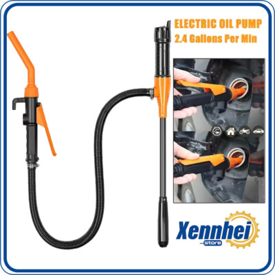

Taps leak. I think the design is excellent. for this very reason.
There is a $12 pump that makes the transfer process quite handy…
It doesn’t get the sludge out of the bottom, but allows you to get your better liquid off quickly.
We have several Wash units and find that it’s best to have SimpleGreen in one, and IPA in the next. We wash in SG, then dip in a ‘splash’ tub of semi-dirty IPA, then wash in the second Wash station with clean IPA.
Every 5-6L of resin printed/processed, we siphon off the top, then pump the bottom gunk out into a vertical separation container. This ‘gunk’ sits around for a month or so, with the tailings of many other tanks, separating into true gunk and reusable.
Then that gets separated again, and the remaining gunk sits in the sun (in a container) for a couple hours to solidify, at which point it can be recycled safely.
