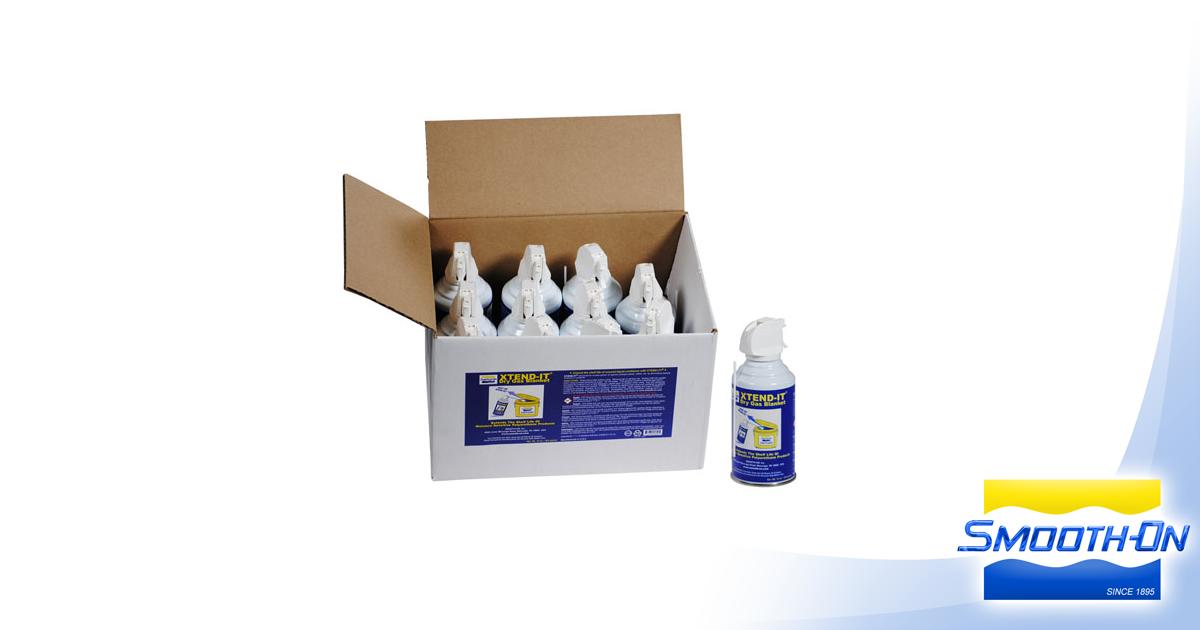

i like the nitrogen gas idea, I use this product for sealing other products that are high in moisture do you think this would work here?
I don’t really know if a “gas blanket” would prevent IPA vapor from penetrating. I would guess you could try and see if you can smell the IPA. Another gas that may work is carbon dioxide.
If I remember my college chemistry correctly, the partial pressure of IPA is fixed for a given liquid IPA concentration. Adding another gas won’t change the steady-state IPA vapor concentration and the permeation rate through plastic will be a function of the material and the IPA vapor pressure.
