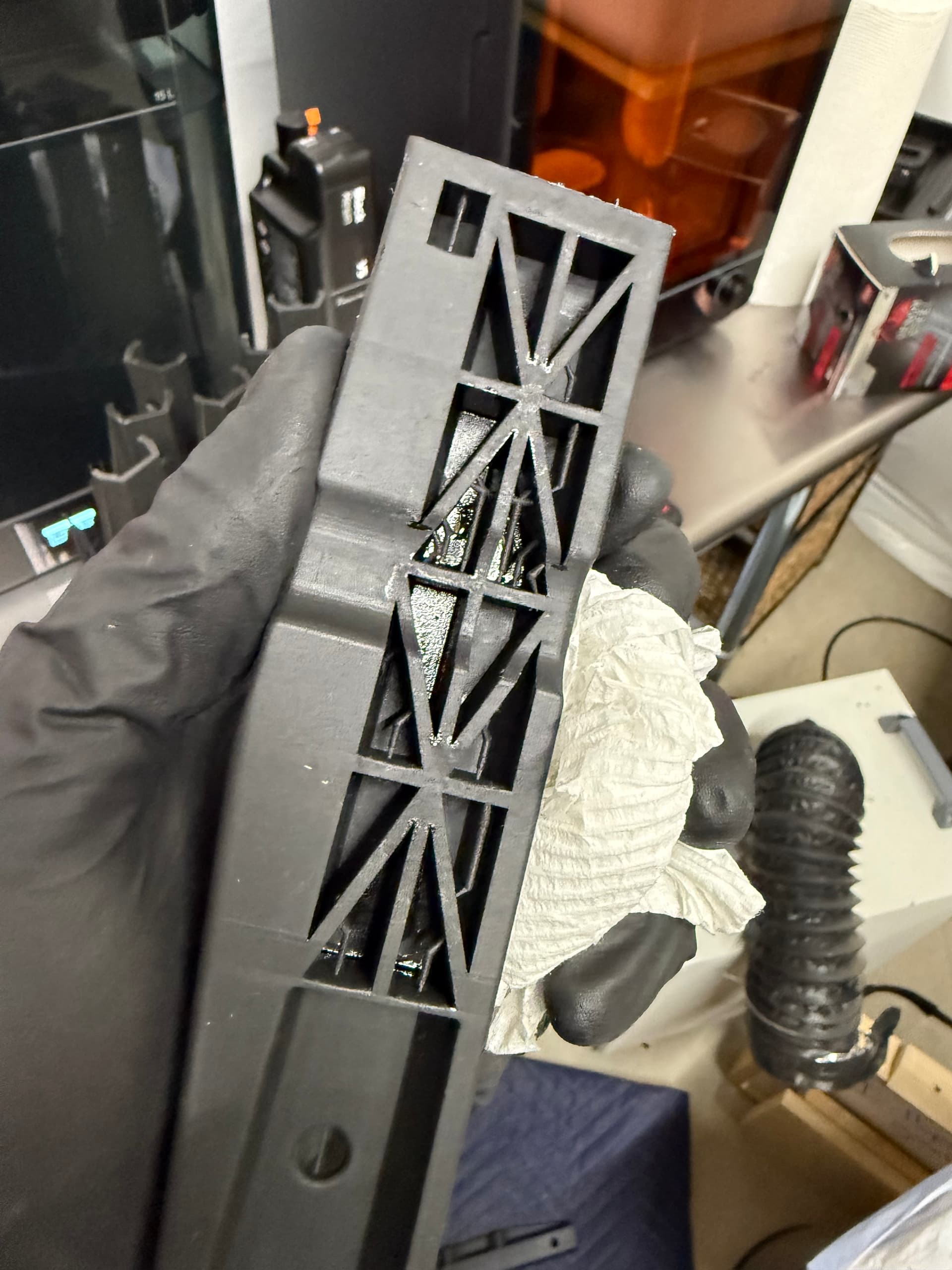

On the SL1S, I could only print one at a time and had to add quite a few supports to get consistent results. Compared to the 14 brackets I have on the form 4 above, with very little supports. The angle of this print is due to the size limitation of the SL1S. if it were larger, I likely would have a similar support structure to that of the form 4 print, but still not nearly as many per print.
external supports literally fell off, leaving no marks or raised marks on the surface. Internal supports inside the webbing takes only seconds with a pointy hobby knife.
This would have taken me about 1.5 weeks on my other printer, and that’s not counting post print work and cleanup. Now it can be done in half a day (from hitting print to final coat of UV sealant drying).

Also your parts look great! After seeing the pictures, I bet you can print these successfully without any supports at all…which would make your life super easy. Vertical, straight on the build plate without supports is always ideal. If you experience elephants foot, there’s a support article online explaining how to fix that too. Preform is generally very conservative and once you get more familiar with what the FL machines can get away with you can really dial down the support size and density.

Thanks! Good to know about the different resin odors, which ones are the strongest in your experience? I think the other resins that I want to use next are the fast model resin, maybe Tough2k, and then the silicone resin. Appreciate the tip on supports for the brackets, give how the body does taper with vertical portions, I think you’re correct that I could print these without supports. I’ll have to try that next. I’ve got a .6 chamfer on these, so there’s very little elephant’s foot at the build platform.

Yeah, because of your gradual overhangs I think those areas don’t need supports at all. The other thing is even with sudden cross sectional area changes, the Form 4 handles those much better than the previous generation because it does one cross section at a time. I am fairly confident (with my limited knowledge of your part) that it would work.
