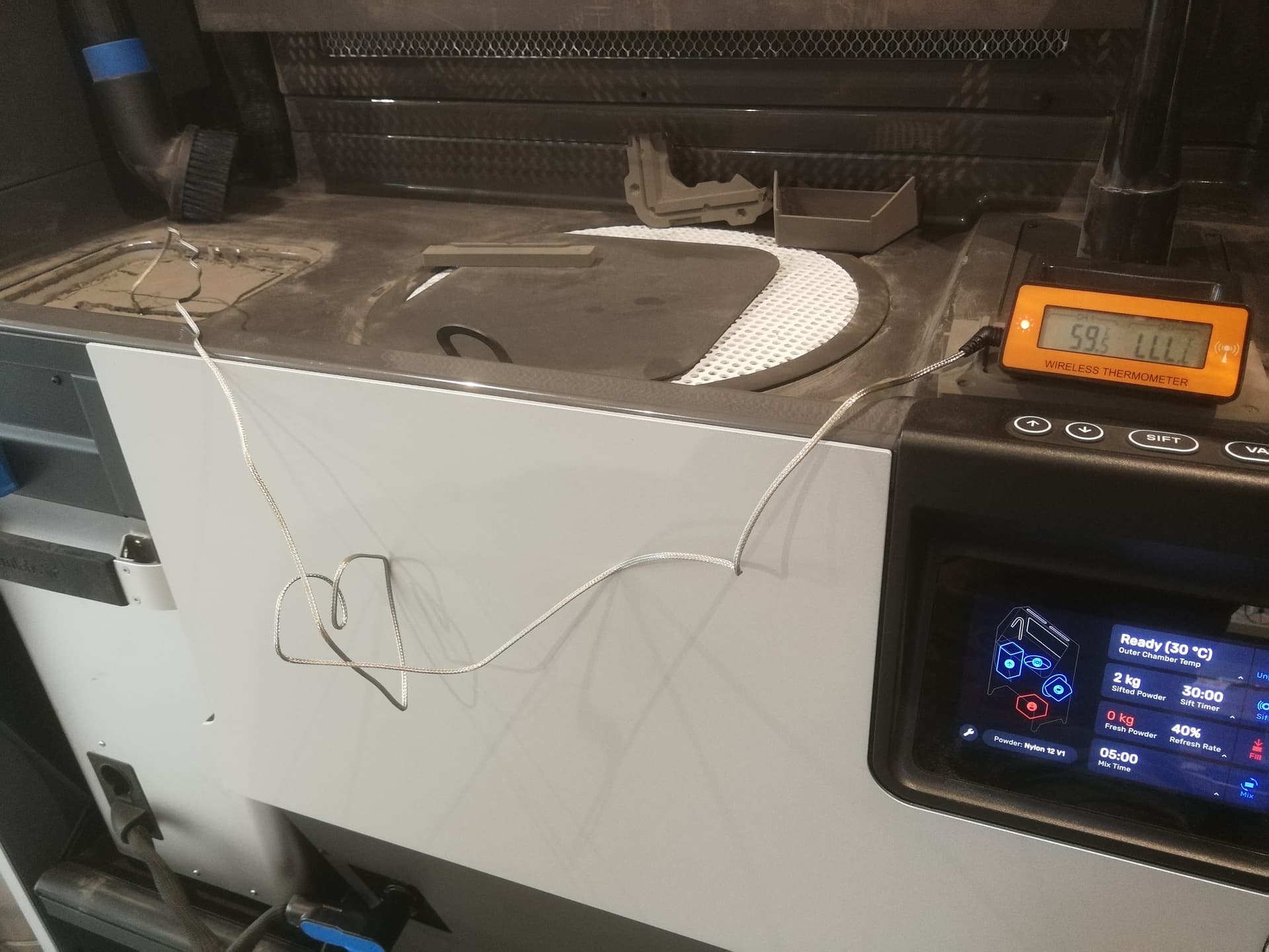

I use a core temperature gauge to measure the inside temperature of the cake, it alsmost doubles the temperature shown on the sift.
For parts that are sensitive to warping, I wait till the inner cake temperature is below 30 degrees Celcius. Takes me 24h longer but results are better.
I am thinking to add a part at the top of each print (like a lid) to avoid fast temperare drops at the cake top, and therefore warping.
Thx for posting your findings, Much appreciated. I think i will have to try the same with a tempgauge when i get back from holiday.
Cheers and i´ll post here once i´ve tried it. I have had a sispicion that the temps are off.
