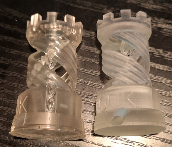

I also have the same problem, I printed an object on my old printer BEAN (kudo3d) with clear resin brand Monocure.
I made the same piece with my new Form2 and clear V4 resin.
There is no photo the first is very transparent, the other opaque, all 2 parts clean in IPA has 99.5%
Form2 new, new resin, new LT Tank …
All the Formlabs standard resins have a matt finish. You can test this yourself by putting a piece into water and it will become transparent. The answer is to paint the piece with a gloss varnish.
Quite the difference in clarity! Related to the printing process itself maybe?
We clean our parts with DIPROPYLENE GLYCOL MONOMETHYL ETHER. Parts come out smoother and with more clarity, but real transparency needs some more finishing.
The stuff is 12.50 euro per liter but lasts way longer and doesn’t evaporate like IPA does(ie. we never have to top-up the form wash in between replacement of the liquid, unheard of for IPA).
I print 2 identical pieces
the one on the left was not cleaned in IPA, but just exposed to UV.
The other was cleaned with IPA, become opaque, and after using a transparent spray, there was an improvement but not like the piece on the left …
Regarding the milky aspect, if it’s well-known that water causes this, I have to ask if it’s possible there is water in the IPA rinse? If you live in a humid environment, even pure IPA is probably hygroscopic enough to absorb water from the air. I guess an easy way to test is to change out the bath with known fresh pure IPA and see if the print still clouds. Does anyone know if the resin itself could absorb water and print cloudy before even touching the IPA?
Isn’t the official recommendation for rinse IPA 70%? The other 30% is water.
Or has something changed?
(I know I’ve had better results with stronger IPA.)
We actually recommend ~90%.
https://support.formlabs.com/s/article/Isopropyl-Alcohol-IPA?language=en_US
It’s not that water makes it cloudy, it’s that the surface is rough. That’s why coating it with resin makes it more transparent because it smooths out the surface.
