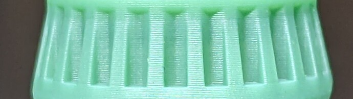

But the custom color produced an inexcusable result:
Expected Custom Color:
Actual Custom Color:
This color had 3 times the black pigment added to it compared to the Walnut color, but it appears as if I added just a small amount of cyan and a drop of yellow to produce an aquamarine or turquoise color. I was aiming for a dark forest green.

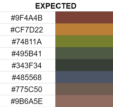

Here is the swatch of colors that I had intended to create, using the Formlabs Custom Color Picker to ensure that the expected color could be produced using the color kit:
Can anyone share their experience in getting colors to more closely match? Are the colors I’m attempting to recreate impossible with this product, or do I simply need to ignore the Custom Color Picker recipe and use my own judgment?
