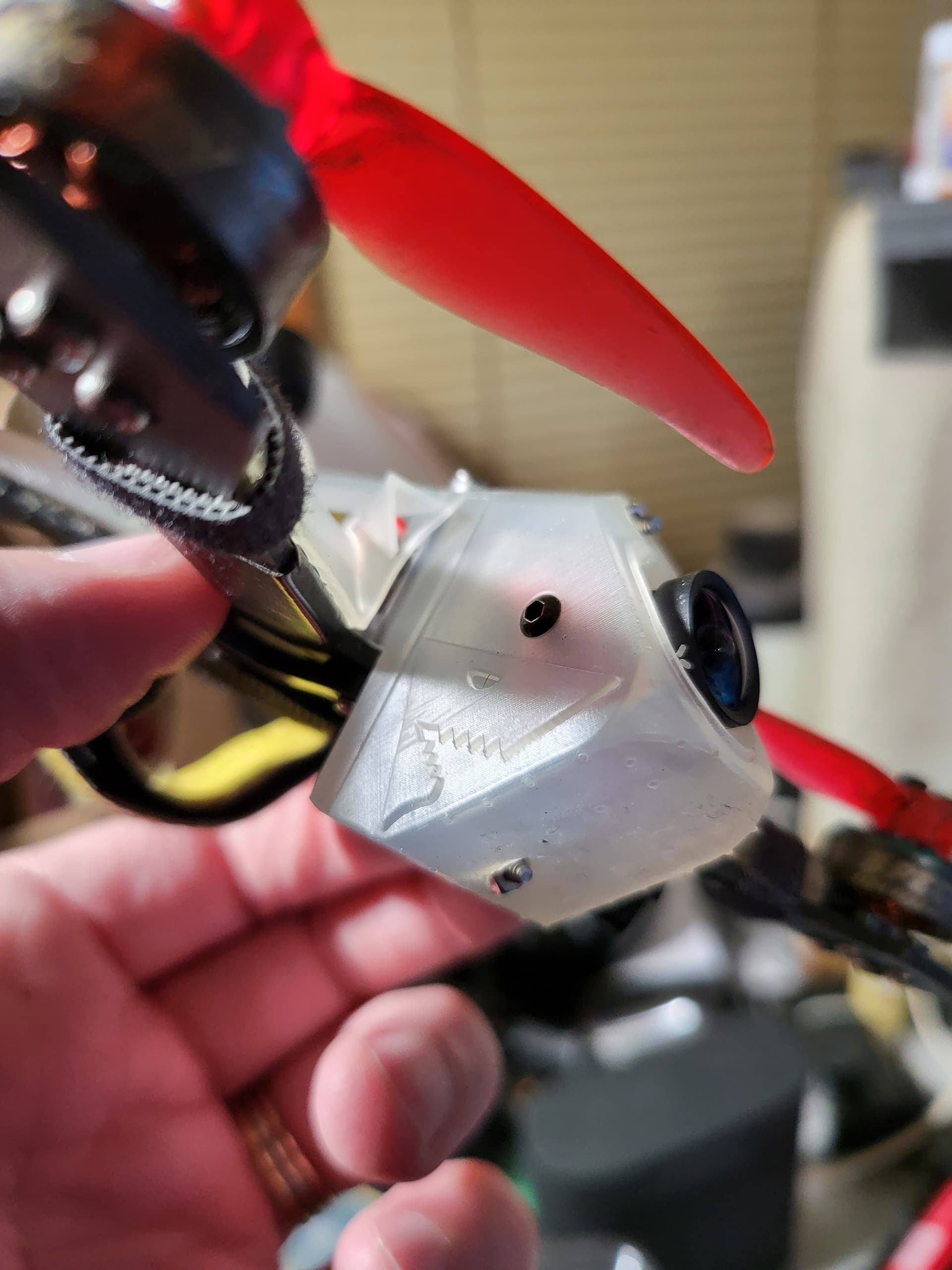

I have been using my printer to make parts for drone racing. You tend to crash a lot when racing drones. Sometimes at very high speeds. So I have been trying different resins to see if I can find one with strong impact resistance. Durable has been the best, so far. And when I print a part in Durable, I do not fully cure it before I paint it, so the resin stays a little “green” and remains more flexible.
That’s a great idea to leave it partially in green state; our guidelines for post-curing are just to get to the specified material properties listed on our site, and oftentimes undercuring (or not curing) certain resins can prove beneficial. I also love the shark head on the printed part!
Originally, the video system I’m using was being marketed by a company called “Fatshark”, and the shark head is their logo. Subsequently, Fatshark decided to develop their own system and the original manufacturer decided to market their product themselves. So I had to change to “HD Zero” on my newer iterations of the design… The logo isn’t as interesting.
