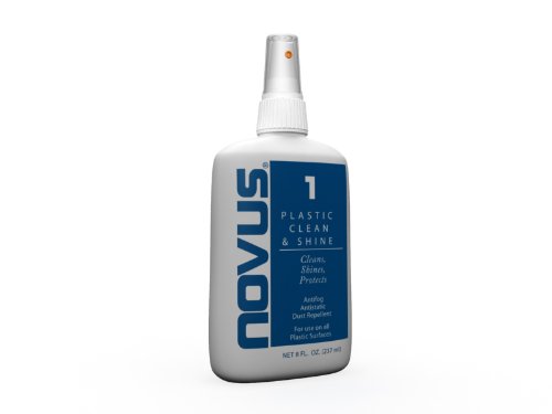

We recommend avoiding isopropanol or ammonia-containing cleaners (like Windex), since these can create small cracks in the cover. We usually wipe the bulk of the resin off with a cloth, then polish off the residue using a product specifically made for acrylic, like Novus 1.
this one works?
