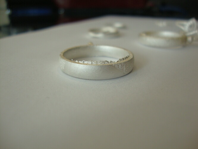

This is silver 925 band below
printing accuracy was 25 microns. Prints were very nice, but after casting they look expanded to the bottow little bit somehow.
last picture is from cell, so the quality is not so good, Anyway result was OK.
Just different diameters of band :slight_smile:
after casting result was just so so, but I am happy with final result.

The burnout process is extremely important and the kind of Investment used is as well. These look like poor burnout or improper burnout.

I had a lot of work with polishing of surfaces in that ring because of casting quality.

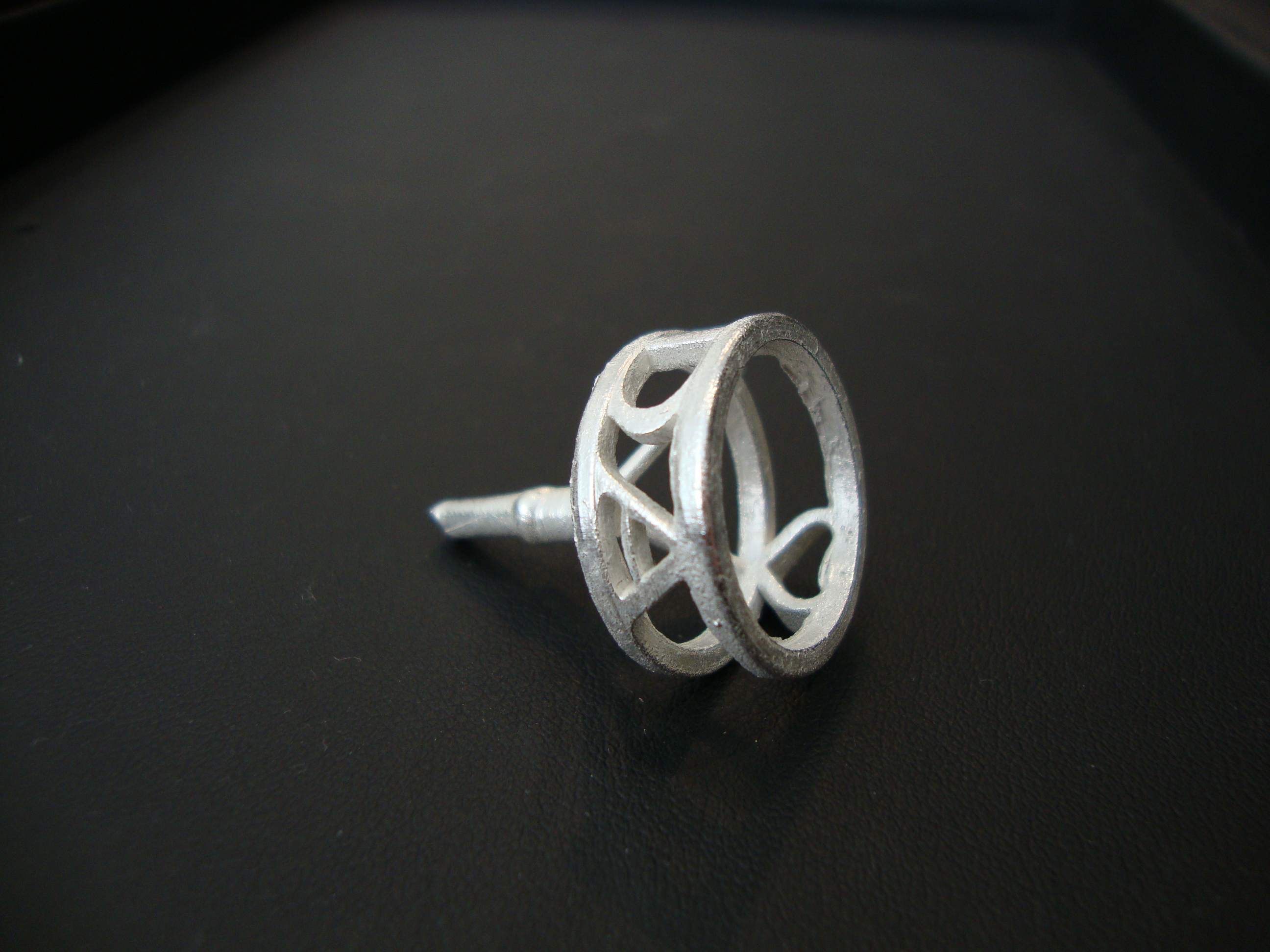

eternity ring
one side is ok, bottomis for shaping
silver 925
some surface is very very nice, some is… hm… different. you can see that on the 4.5mm band
maybe also poor investment or burnou process. maybe
but there is a little progress :slight_smile:
less bubbles on the surface

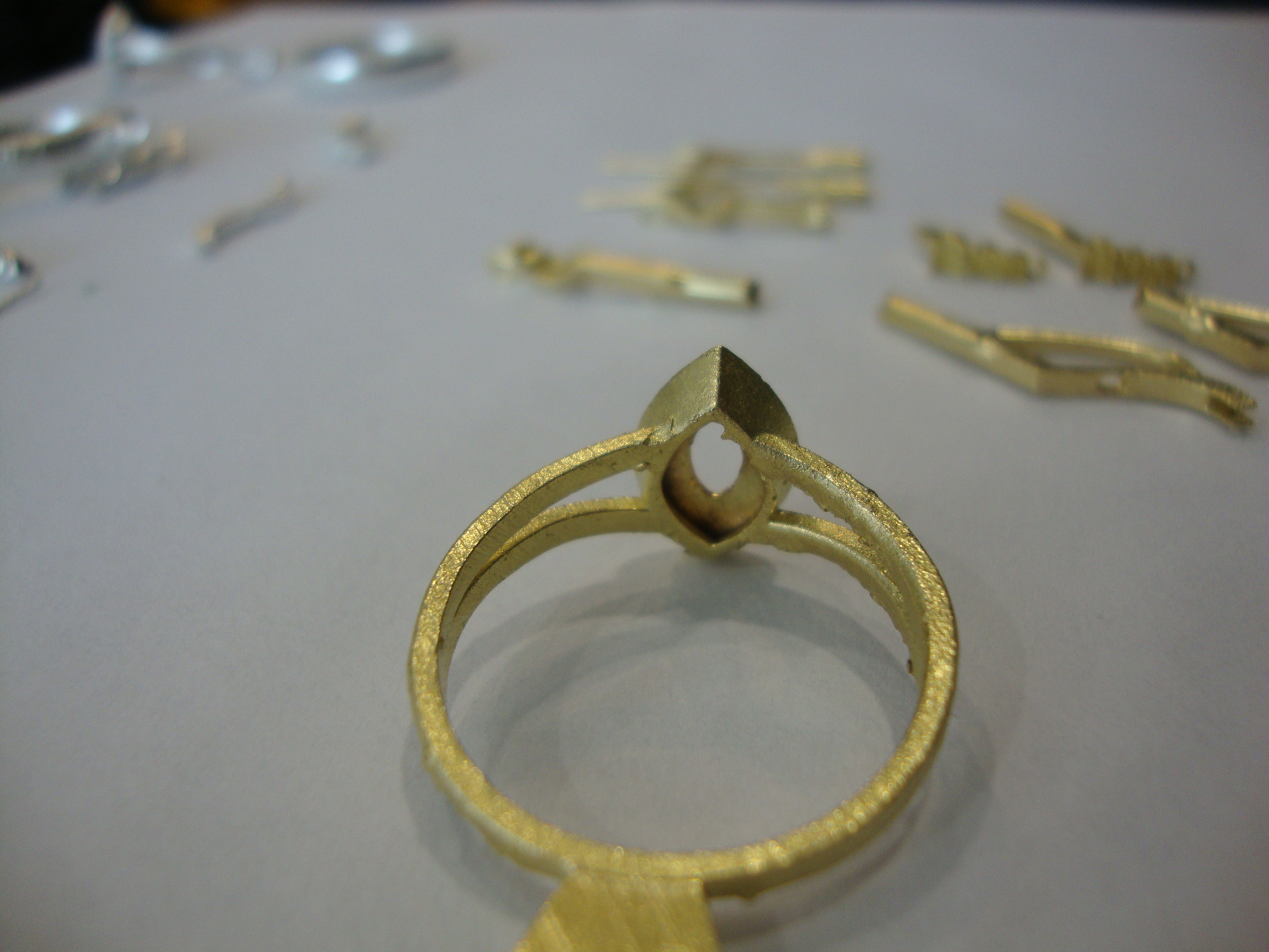

this is another casting company
just want to add important information: prints were very clean. Each one separated in polybag.
14k gold
it is just OK
very small qty of bubbles

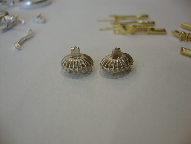

here is 18k
3rd casting company.
it was the best one i think.
Today finished the ring.
I feel that I did shrinkage when curing so long time. I didi it too much.
