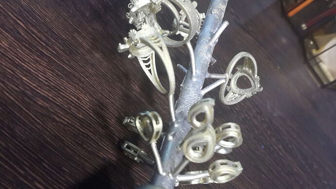

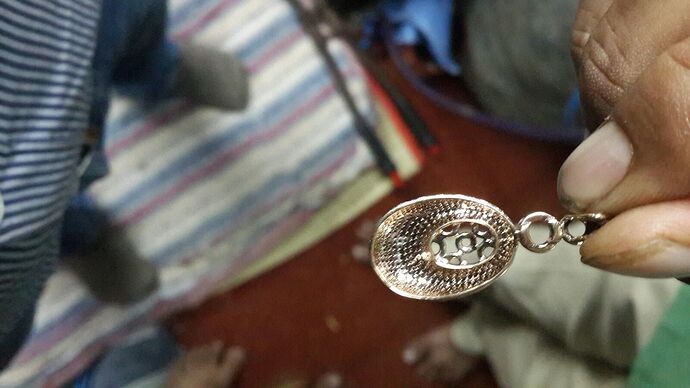

All my work ( all mixed up if start assorting it, would never be able to post it)
Any question welcomed and also nowadays getting best casting result in resin still no hands on special investment powder hard to get it in india (sometime better than wax )
