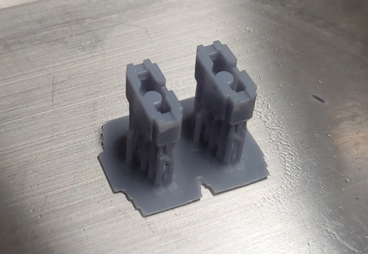

Anyway, I’m in the process of printing the part you posted, and as soon as it’s done and cleaned, I’ll post some photos here.
…about 24 minutes from now.
Here is what I got. The part is very clean. I printed 2 of them in an upright position on my Photon Mono using standard Grey resin.
Please excuse the poor photography, but that’s the best I can do with my phone.
Straight from the printer, cleaned by spraying IPA on it
The part was removed from the support, just pulled it off, not clean up. The support contact spot is .4mm

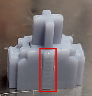

A photo of the inside of the part. I think it came out quite well.
BTW, the total time to print these 2 parts was 48 minutes, but I can fill the build surface with 52 of them and they will print in the same amount of time.

I really appreciate you printing and photographing my model.
They look great, very crisp details. Clearly my Form 3 test was incorrectly angled, makes me wonder how much better they would be printer like you printed yours.
In one of your pictures I noticed some strange lines, do you know what those are and what caused them?

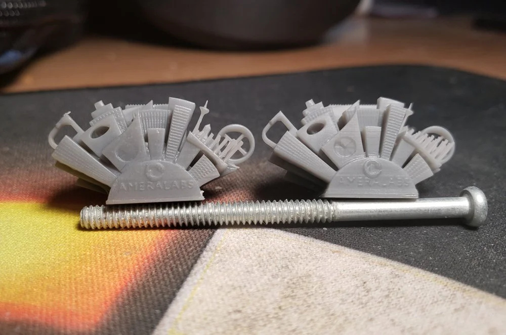

I did find someone who printed the AmeraLabs Town test print on a Form 3 back in 2019 and that wasn’t very impressive. Though as improvements has been made since I’m wondering if anyone in here has printed it lately?
Here is the result from the Form 3 back in 2019.
And here you can download the stl-file if you would like to print it yourself, if you do - please post your result :slight_smile:
There is an updated version of the model, but you need to give up your email address - if you want that one you find it here.
And last is how to interpret the result.
