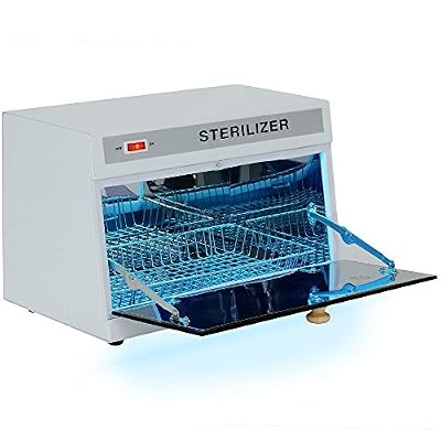

I bought one of the UV sterilizers someone mentioned on the forum earlier this year. I returned it shortly after getting it because it was not curing the prints. It even came with a warning that UV light would produce O3 gas and that was dangerous. I decided hell with it when I smelled the pungent gas. What do you use?
You could be right. Some UV sterilizers aren’t powerful enough and need a stonger bulb in order for the print to cure.

I bought a relatively cheap UV sterilizer off amazon, and it works absolutely great for curing prints.
This is the one I bought. All it did was try to kill me
I have that one too, but I changed the bulb with a black-light bulb. It works better for some reason.

However I’m thinking of getting a more powerful one. This works well for the black resin, the grey, etc., but not so well for the castable resin. Nothing beats the sunlight for that so far for me.
