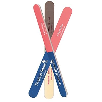

Oh, something I’ve started to use quite a bit is this:
They are four-way buffers that can sand supports nicely, then progressively polish them down, even to a shine. They are also available at beauty supply stores like Sally Beauty.
I took a silversmithing class and they gave them away as part of the class kit. I’d been buying larger sets of emery boards for jewelry…this particular buffer has the perfect assortment of grits.
Kat, this is great too. I’ve been using 220 down to 320 grit sandpaper by hand and with a dremel tool.
Any idea how fine of a grit the Tropical Shine 4-way would be compared too?
I have something like this that i stole from my girlfriend. Its meant for nails i guess, it has something like 7 sanding surfaces, the lowest being something like 240/320 and the finest must be something like 5000, it’s ultra fine and really just there to polish. Pretty useful to remove the support pimples from something with a surface texture

@Paraglyphs, my guess is that the coarsest grit is a 400, then maybe a 600, then 800, then one that is very smooth and buffs to a shine? I used to go through the whole course of grits with my emery sticks so I was skeptical of this. For the jewelry class I was in, this provided everything we needed to bring our pieces to a high gloss finish (silver).
They seem a little expensive for what they are, but what I was using previously seemed like overkill and I wasn’t using all of the grits. https://www.riogrande.com/product/Hermes-Sanding-Board-Assortment-Pkg-of-6/337458 . I think the Rio Grande option is still more cost-effective because three single-grit boards are like $5 if you know what you need (I was purchasing the assortment). But the Tropical Shine are pretty convenient, and you get to know the colors (they are also numbered) so sanding in progressively finer grits is very easy.
