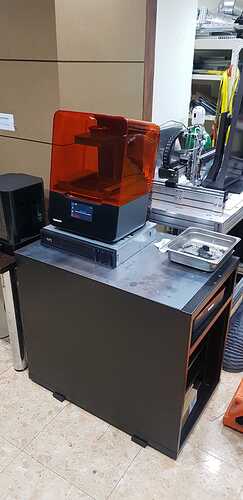

I’m using an Eaton 9PX1000iRT2U (that’s the 230V model, the 120V I think is 9PX1000RT2U without the i).
I figured the printer probably isn’t too sensitive to minor fluctuations (will have a switchmode PSU after all) but a dual-converstion UPS was better than a line-interactive - considering the cost of the printer even the more expensive UPS seems a pretty trivial cost.
For just my F3, it should last more than 3 hours during a print - the printer uses quite a bit of power at the beginning while it’s heating, mixing, and whatever else, but settles down to very low consumption for the remainder of the print.
If you need longer, can stack up to 4 additional battery packs onto it.

While that works and may give extra stability I would personally recommend covering the rack UPS somehow. Spills may happen (for countless reasons) and that may not be a good thing in a UPS.
A 2U mini rack can also do the trick.
