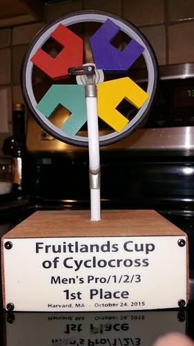

I noticed that on the first 3d print of the human figure there are no lines on it which is great. But how come on the second one the Fruitlands Cup there are lines on the Red Purple Yellow parts?
Intentional, but yes, achieved by positioning the model horizontally for printing. Intent was to make it look like the little houses had clapboard siding without putting myself through the aggravation of modeling that feature in to the geometry.
Came out great on the side facing forward. Unfortunately, because the positioning of the model was horizontal there’s a lot of “tugging” on the supports when each layer is peeled, which gave the back side of the print (where all the supports were touching) a dimpled “chicken skin” texture I had to manually clean up with sanding. So the house faces are flat/smooth on the back side of the trophy.
There’s not a lot of magic to getting paint to stick.
Make sure the model is cleaned and post-cured enough the surface is hard and dry not soft and tacky
Choose a primer with an appropriate base color for the paints you intend to apply, I used automotive primer because that’s what I had on hand
Prime
Paint
On my “head”, I used Testors plastic model enamel paint. On the trophy I used Tamiya Acrylic. The final result looks about the same but the Acrylic needed more coats.
