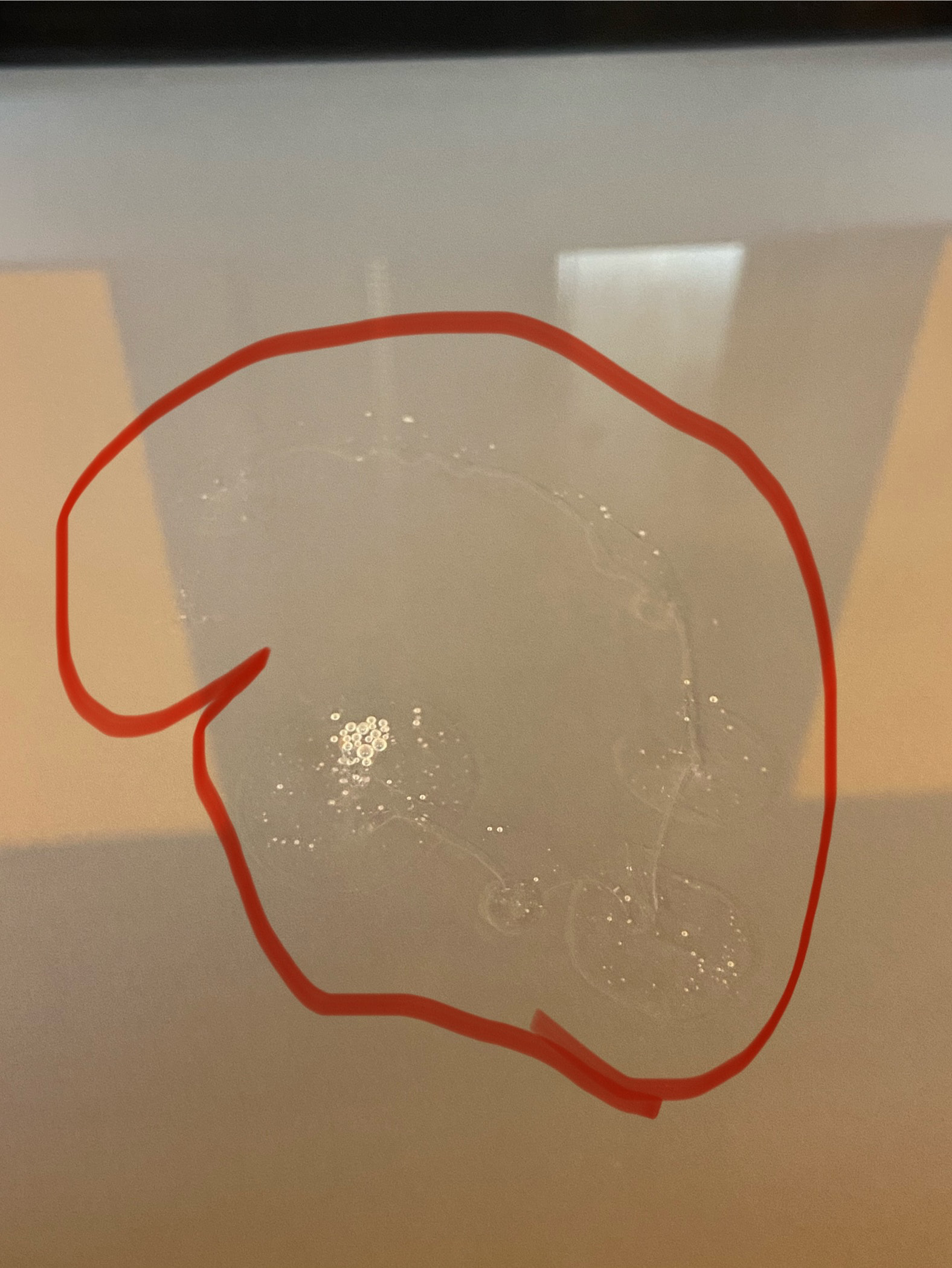

I ended up needing to mix the two versions, almost a 50/50 ratio to print a 700mL part. After reading a bit here on the forum, I was worried that the print might show a visible line or different transparency levels. I even dropped some resin into the tank just to check the dilution, and I could clearly see different phases… Not a great sign, but I had no choice, I reprogrammed the tank and started the job. :eyes:
But here’s the result: a beautiful and uniform part. So if anyone needs to mix these two versions, don’t worry, it will probably turn out just fine. :grin:
