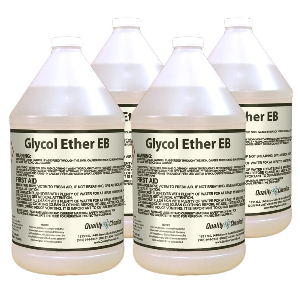

Does anyone know where you can buy DPM in the United States? Since IPA is sold out everywhere due to the COVID-19 I’m in great need of an alternative solvent. Yellow Magic Seven works but it doesn’t seem to get all the resin off easily like IPA does. The surface finish seems compromised. I would like to find DPM but I can’t fine a supplier. Does anyone know if the items shown from McMaster-Carr in the image below are correct?
